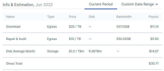

For me:
“egressBandwidth”:557145592320,“egressBandwidthPayout”:1114.3,
“egressRepairAudit”:550019326464,“egressRepairAuditPayout”:550.02,
“diskSpace”:9380959761636.012,“diskSpacePayout”:1407.14,“heldRate”:0,“payout”:3071.46,
@Stob Ahh ok thanks now i have the solution for others who ask there are a few posts about this by other users with out solution i don’t know if some people realise that it’s cents
