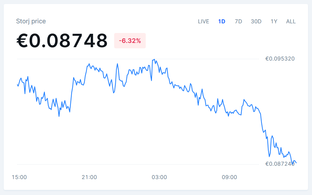

2 weeks later…: “Coinbase: 100$ were exchanged for 2000 Storj”. :smiling_face_with_sunglasses:
It’s just statistics. Storj in 12m performance: -69%.
-9.6 per month (compound). More you wait more you’ll lose.
Things are going to change? A massive buy pressure incoming? Probably and probably not. Gambling or not gambling? up to you guys :slight_smile:

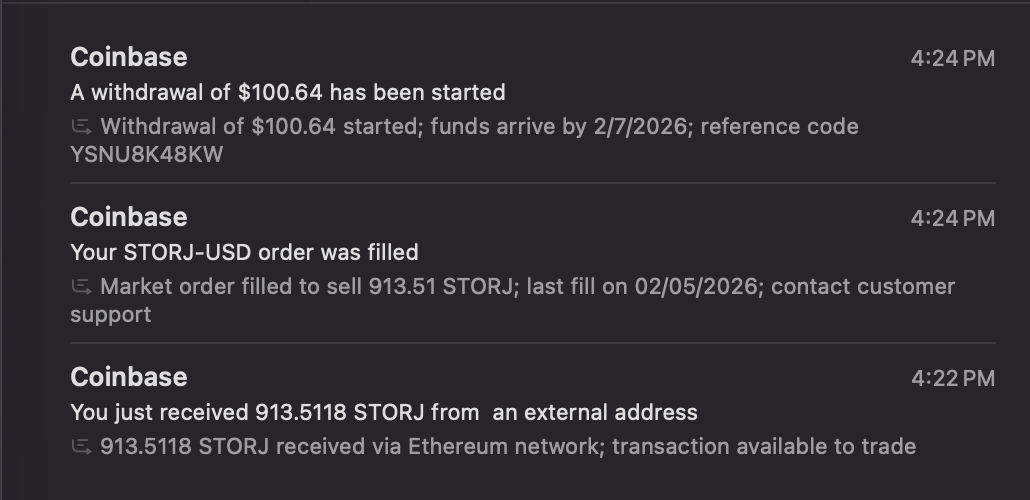

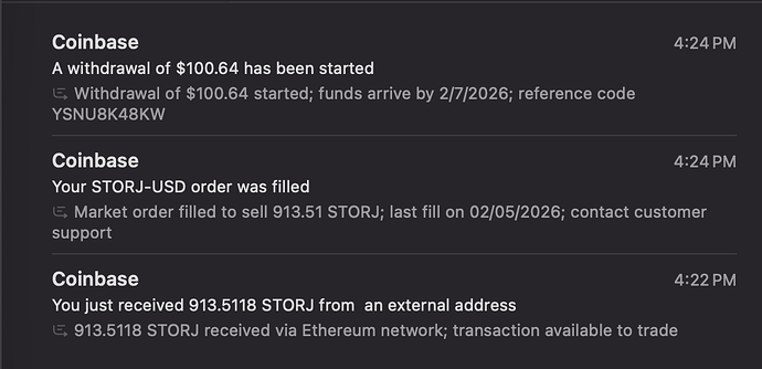

This is a skill issue :squinting_face_with_tongue: . You choose where to send your payouts, and where to sell, and if you market-sell or try to manage an asking price. And you made choices that meant it took 12h to get your money.
@arrogantrabbit made different choices and had USD in 2 minutes. And it’s not a Coinbase thing: crypto.com is just as fast!

  • No local TLS needed
  • Ensure Tunnel forwards /webhook to localhost:8000
Coinbase webhook target → HTTPS Cloudflare → local Flask HTTP.
Optional: Caddy HTTPS Termination
If you do not have Cloudflare Tunnel and need public HTTPS:
  1. Install Caddy
pkg install caddy
  1. Caddyfile
    Place at /usr/local/etc/caddy/Caddyfile:
storj-autosell.example.com {
    reverse_proxy 127.0.0.1:8000
  • Replace storj-autosell.example.com with your DNS name.
  • Caddy will automatically obtain and renew Let’s Encrypt certificates.
  1. Start Caddy
service caddy start
  1. Set:
WEBHOOK_HOST=https://storj-autosell.example.com
before running the Python script.
Steps to Deploy
  1. Set up HTTPS (Cloudflare Tunnel or Caddy)
  2. Set environment variables
  3. Run:
    python3 storj_autosell.py
  4. Coinbase will deliver webhook events to:
    https://<WEBHOOK_HOST>/webhook
  5. On deposit, script places a market sell order.
Notes
  • You must update WEBHOOK_LISTENER_SECRET after subscription creation.
  • Coinbase API requires trade permissions for order placement.
  • Coinbase will deliver only to valid public HTTPS endpoints.
