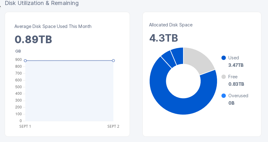

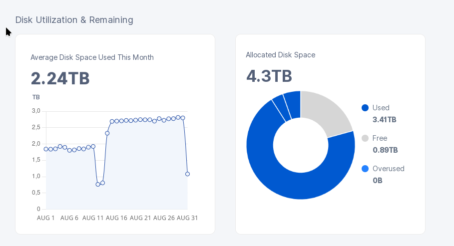

  • Last month: The graph and text values for average disk space were inconsistent with each other

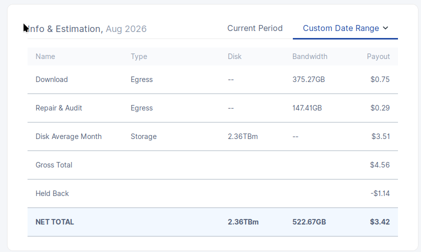

  • This month: The graph and text are now consistent with each other, but together they show only approximately 1/3 of the actual storage capacity that is genuinely being used on my node
  • Additional concern: The payout calculation appears to have used the incorrect value from last month’s anomaly

  1. Why is the displayed average disk space only showing 1/3 of the actual used storage?
