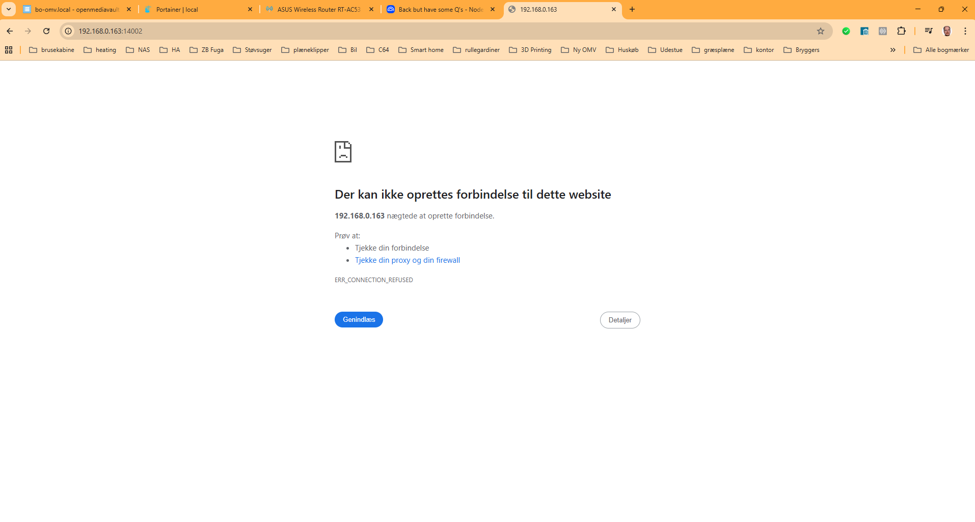

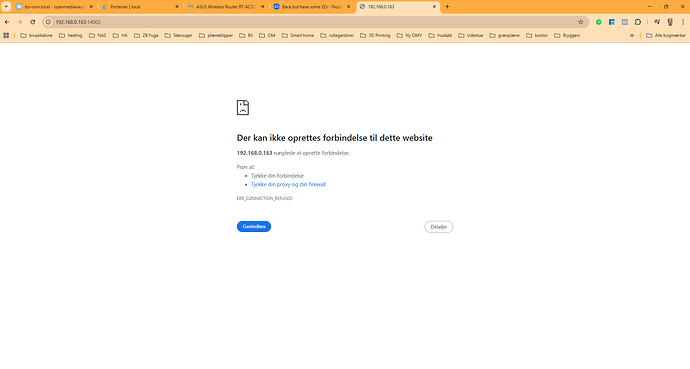

i tried to deplay it in portainer….
it says its running
{1816C6AC-D99B-469A-B3AA-799C95E397DD}
but no access to the dashboard:

i run it from portainer and the stack editor does not say what user it runs as, the below pic is before i drop the stack file above
last 40 lines of log:
