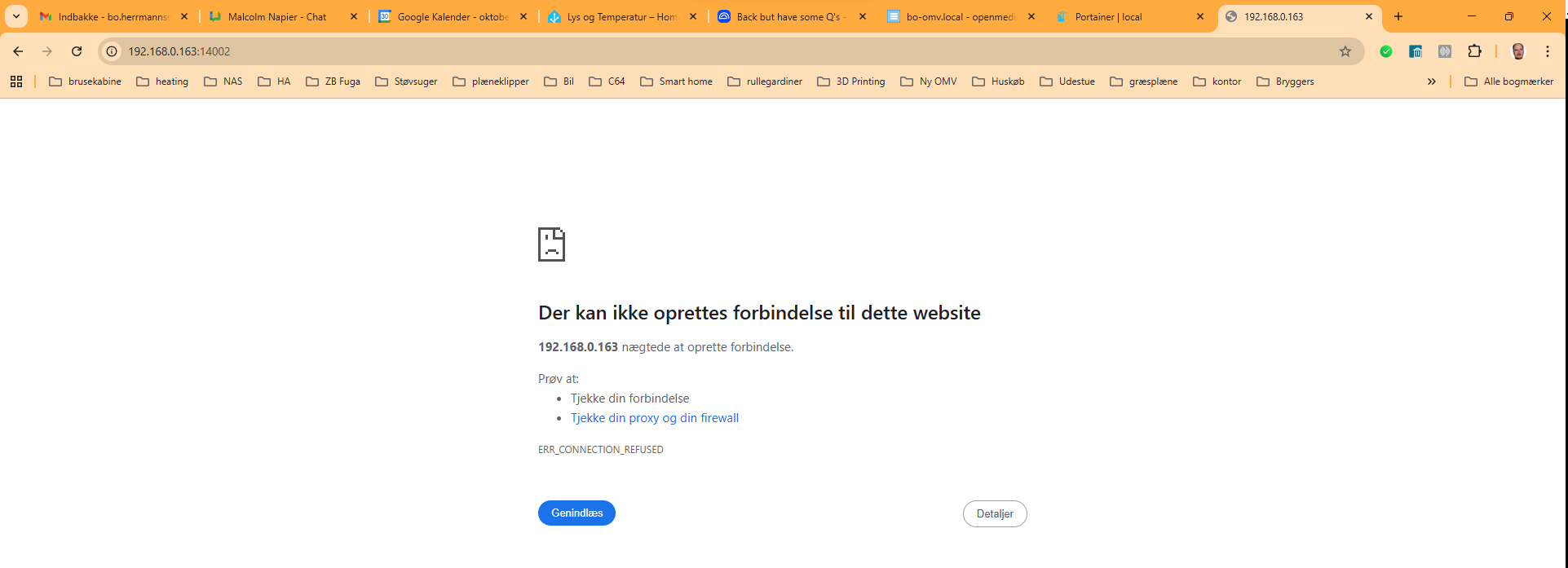

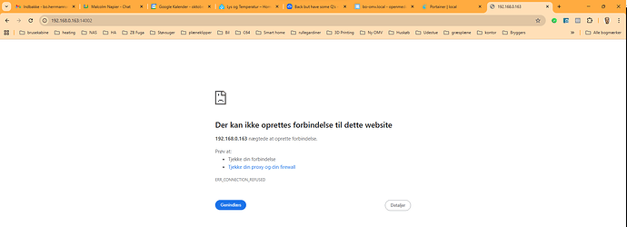

of course some invalid keys… but then either my stack/compose file is wrong or it does not read from it???
Should be a bunch more logs after that.
Console would be http://192.168.0.163:14002
no console
root@bo-omv:/mnt/storj/Storage# sudo docker logs --tail 40 storagenode1

seems db is locked again?
EDIT: now its back to ā€œrunning stateā€
EDIT2: so it switches between the 2 logs i provided…. are there better ways to get logs than doing: docker logs --tail 40 storagenode1 ?
EDIT3: for fun i looked in the yaml file
server address of the api gateway and frontend app
console.address: 0.0.0.0:14002
funny enough contact.external-address: is set correctly to the correct ip
will try and correct the console address
EDIT4: nope… still no console, and it jumps between running state and DB locked
console will be on localhost:14002, to use it externaly you need to config your ip addres in config
you did look at my compose file right? or am i doing it wrong?
and as i wrote i tried to correct the yaml file with no luck
I set (in config.yaml) - and create config/logs folder - you will need to rotate the log somehow yourself - docker stuff with ā€œdocker logs ā€¦ā€ and storj stuff by ā€œtail -f /mnt/your/storjpath/config/logs/storjnode.logā€ :
config.yaml:
log.output: /app/config/logs/storjnode.log
The config.yaml is created when run with SETUP=true using values from command line and environment.
Console is not visible, because its still crashing due to databases. Permissions again?

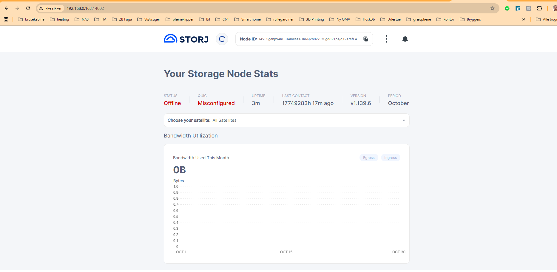

for fun i started over with deleting everything in storage folder and running with setup option

root@bo-omv:/mnt/storj/Storage# docker logs --tail 40 storagenode1
2025-10-30 09:56:23 (5.73 MB/s) - '/tmp/storagenode.zip' saved [39558039/39558039]
Running /app/bin/storagenode setup  --config-dir config --identity-dir identity --version.server-address=https://version.storj.io --storage.allocated-disk-space=2TB --contact.external-address=****:28967 --operator.email=**** --operator.wallet=****
2025-10-30T09:57:43Z    INFO    Configuration loaded    {"Process": "storagenode", "Location": "/app/config/config.yaml"}
2025-10-30T09:57:43Z    INFO    Anonymized tracing enabled      {"Process": "storagenode"}
Error: storagenode configuration already exists (/app/config)
soo it seems to do this correctly…. but yes i need to rotate logs more…
EDIT: it jumps between
2025-10-30T10:00:16Z    INFO    Invalid configuration file key  {"Process": "storagenode-updater", "Key": "storage.allocated-disk-space"}
2025-10-30T10:00:16Z    INFO    Invalid configuration file key  {"Process": "storagenode-updater", "Key": "server.private-address"}
2025-10-30T10:00:16Z    INFO    Invalid configuration file key  {"Process": "storagenode-updater", "Key": "server.address"}
2025-10-30T10:00:16Z    INFO    Invalid configuration file key  {"Process": "storagenode-updater", "Key": "healthcheck.enabled"}
2025-10-30T10:00:16Z    INFO    Invalid configuration file key  {"Process": "storagenode-updater", "Key": "healthcheck.details"}
2025-10-30T10:00:16Z    INFO    Invalid configuration file key  {"Process": "storagenode-updater", "Key": "operator.wallet"}
2025-10-30T10:00:16Z    INFO    Anonymized tracing enabled      {"Process": "storagenode-updater"}
2025-10-30T10:00:16Z    INFO    Running on version      {"Process": "storagenode-updater", "Service": "storagenode-updater", "Version": "v1.139.6"}
2025-10-30T10:00:16Z    INFO    Downloading versions.   {"Process": "storagenode-updater", "Server Address": "https://version.storj.io"}
2025-10-30T10:00:16Z    INFO    Configuration loaded    {"Process": "storagenode", "Location": "/app/config/config.yaml"}
2025-10-30T10:00:16Z    INFO    Anonymized tracing enabled      {"Process": "storagenode"}
2025-10-30T10:00:16Z    INFO    Operator email  {"Process": "storagenode", "Address": "****"}
2025-10-30T10:00:16Z    INFO    Operator wallet {"Process": "storagenode", "Address": "****"}
2025-10-30T10:00:16Z    INFO    db      database does not exist {"Process": "storagenode", "database": "info"}
2025-10-30T10:00:16Z    INFO    db      database does not exist {"Process": "storagenode", "database": "bandwidth"}
2025-10-30T10:00:16Z    INFO    db      database does not exist {"Process": "storagenode", "database": "orders"}
2025-10-30T10:00:16Z    INFO    db      database does not exist {"Process": "storagenode", "database": "piece_expiration"}
2025-10-30T10:00:16Z    INFO    db      database does not exist {"Process": "storagenode", "database": "pieceinfo"}
2025-10-30T10:00:16Z    INFO    db      database does not exist {"Process": "storagenode", "database": "piece_spaced_used"}
2025-10-30T10:00:16Z    INFO    db      database does not exist {"Process": "storagenode", "database": "reputation"}
2025-10-30T10:00:16Z    INFO    db      database does not exist {"Process": "storagenode", "database": "storage_usage"}
2025-10-30T10:00:16Z    INFO    db      database does not exist {"Process": "storagenode", "database": "used_serial"}
2025-10-30T10:00:16Z    INFO    db      database does not exist {"Process": "storagenode", "database": "satellites"}
2025-10-30T10:00:16Z    INFO    db      database does not exist {"Process": "storagenode", "database": "notifications"}
2025-10-30T10:00:16Z    INFO    db      database does not exist {"Process": "storagenode", "database": "heldamount"}
2025-10-30T10:00:16Z    INFO    db      database does not exist {"Process": "storagenode", "database": "pricing"}
2025-10-30T10:00:16Z    INFO    db      database does not exist {"Process": "storagenode", "database": "secret"}
2025-10-30T10:00:16Z    INFO    db      database does not exist {"Process": "storagenode", "database": "garbage_collection_filewalker_progress"}
2025-10-30T10:00:16Z    INFO    db      database does not exist {"Process": "storagenode", "database": "used_space_per_prefix"}
2025-10-30T10:00:16Z    INFO    server  kernel support for server-side tcp fast open remains disabled.  {"Process": "storagenode"}
2025-10-30T10:00:16Z    INFO    server  enable with: sysctl -w net.ipv4.tcp_fastopen=3  {"Process": "storagenode"}
2025-10-30T10:00:16Z    INFO    Current binary version  {"Process": "storagenode-updater", "Service": "storagenode", "Version": "v1.139.6"}
2025-10-30T10:00:16Z    INFO    Version is up to date   {"Process": "storagenode-updater", "Service": "storagenode"}
2025-10-30T10:00:16Z    INFO    Current binary version  {"Process": "storagenode-updater", "Service": "storagenode-updater", "Version": "v1.139.6"}
2025-10-30T10:00:16Z    INFO    Version is up to date   {"Process": "storagenode-updater", "Service": "storagenode-updater"}
2025-10-30T10:00:17Z    INFO    Telemetry enabled       {"Process": "storagenode", "instance ID": "14VL5gehjW4KB314meez4UKRQVh8v79Migd8VTp4jqX2s7efLA"}
2025-10-30T10:00:17Z    INFO    Event collection enabled        {"Process": "storagenode", "instance ID": "14VL5gehjW4KB314meez4UKRQVh8v79Migd8VTp4jqX2s7efLA"}
2025-10-30 10:00:18,132 INFO success: processes-exit-eventlistener entered RUNNING state, process has stayed up for > than 1 seconds (startsecs)
2025-10-30 10:00:18,132 INFO success: storagenode entered RUNNING state, process has stayed up for > than 1 seconds (startsecs)
2025-10-30 10:00:18,132 INFO success: storagenode-updater entered RUNNING state, process has stayed up for > than 1 seconds (startsecs)

EDIT2: yep the satelittes cant connect
2025-10-30T13:01:48Z    ERROR   contact:service ping satellite failed   {"Process": "storagenode", "Satellite ID": "12L9ZFwhzVpuEKMUNUqkaTLGzwY9G24tbiigLiXpmZWKwmcNDDs", "attempts": 1, "error": "ping satellite: failed to ping storage node, your node indicated error code: 0, rpc: tcp connector failed: rpc: dial tcp ****:28967: connect: connection timed out", "errorVerbose": "ping satellite: failed to ping storage node, your node indicated error code: 0, rpc: tcp connector failed: rpc: dial tcp ****:28967: connect: connection timed out\n\tstorj.io/storj/storagenode/contact.(*Service).pingSatelliteOnce:232\n\tstorj.io/storj/storagenode/contact.(*Service).pingSatellite:169\n\tstorj.io/storj/storagenode/contact.(*Chore).updateCycles.func1:89\n\tstorj.io/common/sync2.(*Cycle).Run:102\n\tstorj.io/common/sync2.(*Cycle).Start.func1:77\n\tgolang.org/x/sync/errgroup.(*Group).Go.func1:93"}
EDIT3:

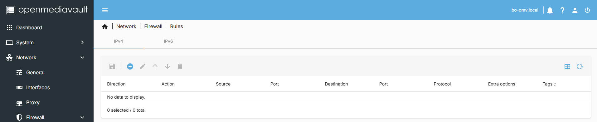

port forward in router
{793BC863-D225-458A-9F50-CCB38F4A33BD}
whatismyip.com reports the same ip as set in external address
no firewall set
EDIT4:
something must be blocking access from the outside…. i have fired an email to my ISP that has just setup my static ip… ssh does not work either
