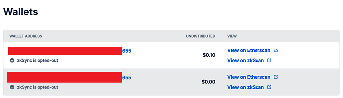

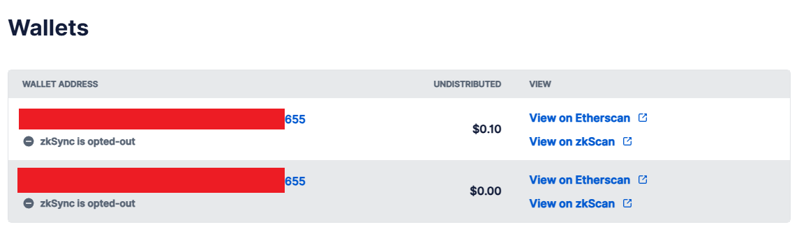

Q. is it normal that multinode dashboard shows more than one wallet even thou the same is used for all nodes?
If some are different, then you used a different wallet on one or several your nodes. If they are the same, then yes. This is a current design. The work on the multinode dashboard has stopped, and it has bugs.

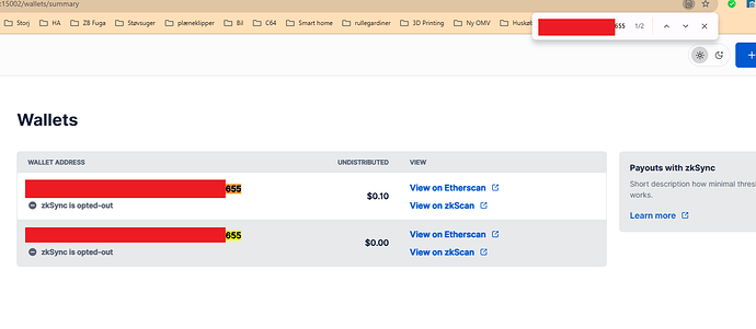

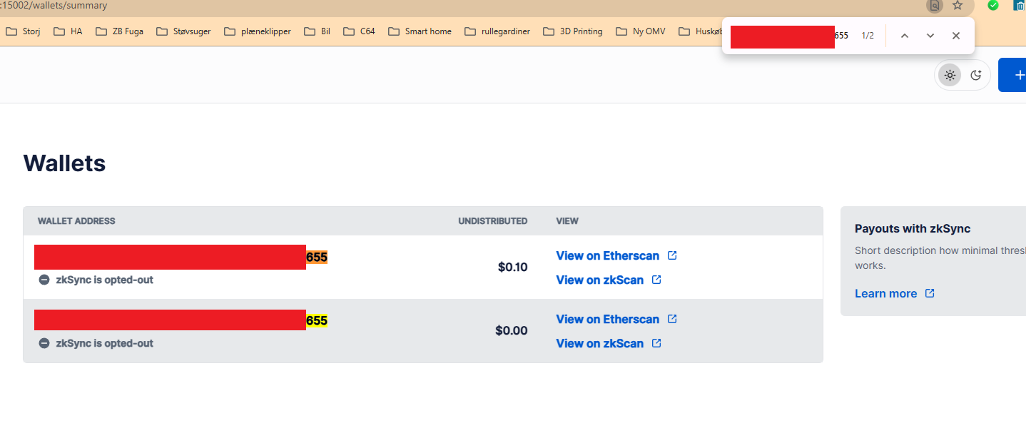

You may also check the dashboard with Ctrl-F.
that just opens search box… also tried ctrl+r and shift+f5
still got 2 wallet address’s that are the same
Yes, that’s what I mean, use the search function to make sure they are exactly the same.
This list shows wallets from all nodes, it doesn’t group them or makes unique. In some cases it may be useful, if some nodes have a different wallet, so you may easily figure out which one.
they are the same, that is the benefit of copy+paste, they dont change
may be some space in end or beginning difference, end of line or something not trivial.
was the first thing i checked, all 4 nodes have the same wallet, no space in the beginning or end
so anyone knows why i get 2 wallets listed in the multi node dashboard when only 1 address is used for all 4 nodes? and yes its the same pasted from notepad, no space before and after
