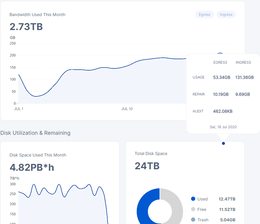

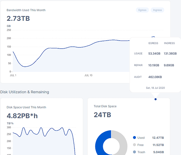

Is ‘Egress’ in your calculator only ‘Usage’ or does it also include ‘Repair’?
For my first node I have 47.72 GB Usage + 11.28 GB Repair + 381 KB audit for a total Egress of 59 GB.
include repair as well since we don’t worry about payouts but rather focus on the total amount of egress

initially when we started, we checked the ingress… and tried to compare it… but after a while it became clear that adding both regular ingress and repair ingress together gave us insanely accurate numbers… additionally all nodes from each SNO is also added… so ingress + repair ingress + same for additional nodes which gives the total daily ingress
this ingress will most often be within 1% of other nodes running smoothly , ofc minor variations do seem to factor in…
i extended this practice to the egress also… all egress/repairE of all nodes of a SNO is simply added into a daily total.

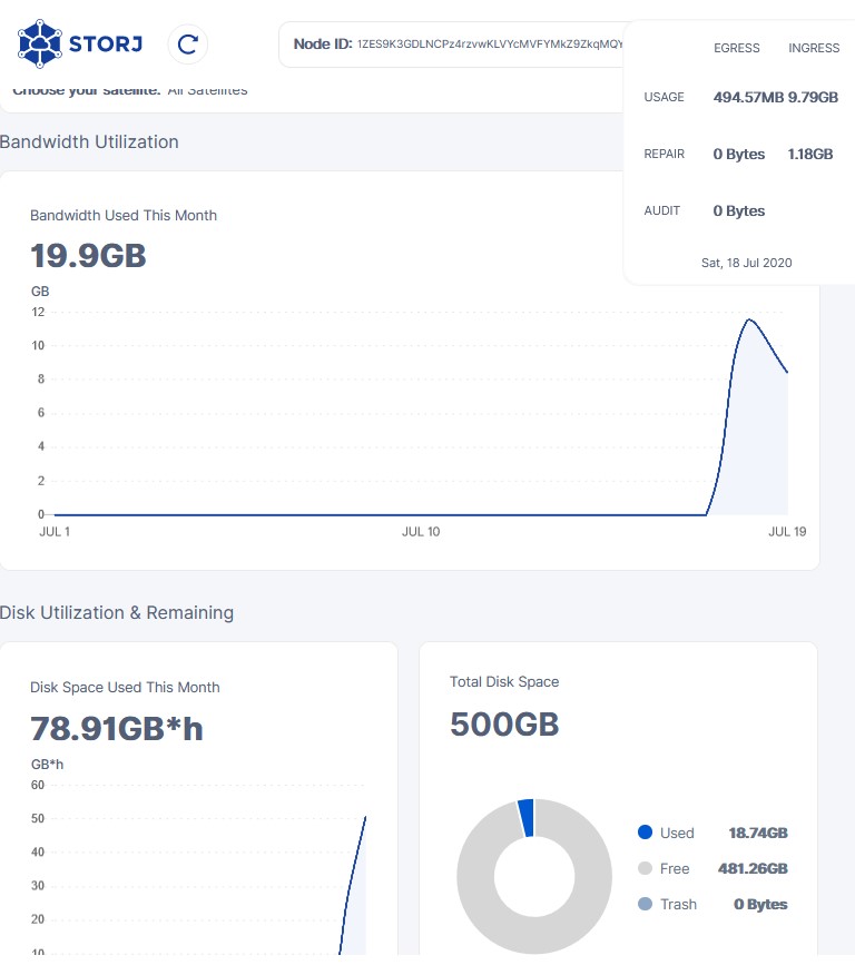

Just added a second node on the same hard drive so that it’s vetted whenever I decide to get a second HDD. It also minimizes the held back amount so less money lost if node ends up corrupted.
Yesterday was a good day :slight_smile:

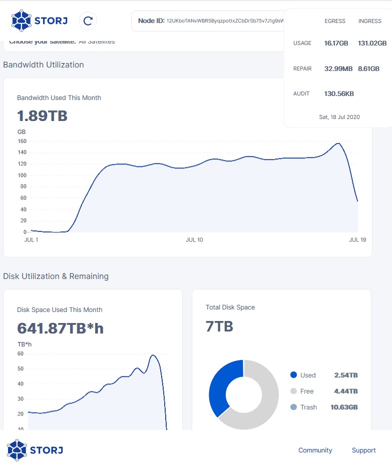

Did anyone else see a sharp increase in ingress yesterday ?
My ingress shot up to 150GB from a consistent 120GB the last couple of weeks.
I checked the dashboard, I was wondering if some satellite other than europe-north started uploading but no. Ingress from all satellites decreased yesterday and europe-north increased by about 20GB.
I’ve noticed that on my node also.
Maybe they are testing what is real amount of free storage (in case people “state” too much free space)
