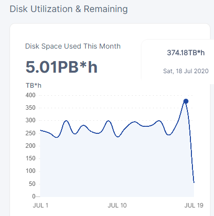

anyone else get this spike today…
@TheMightyGreek
see why one cannot use that graph for much…
from 250 to 375 in a day and then tomorrow it will most likely do a deep dive…
it’s numbers are so unreliable it’s ridiculous…
I actually had a slight dip compared to the day before yesterday even with the 120GB of ingress…
Yep, I saw it too. Looking at the “All Satellite” Graph and then drilling down to the individual satellite graphs, it appears that it’s the Saltlake satellite that has the most variation from day to day, and specifically had the big spike up yesterday. That satellite has always had some issues with reporting consistent space used data on a day-to-day basis.
