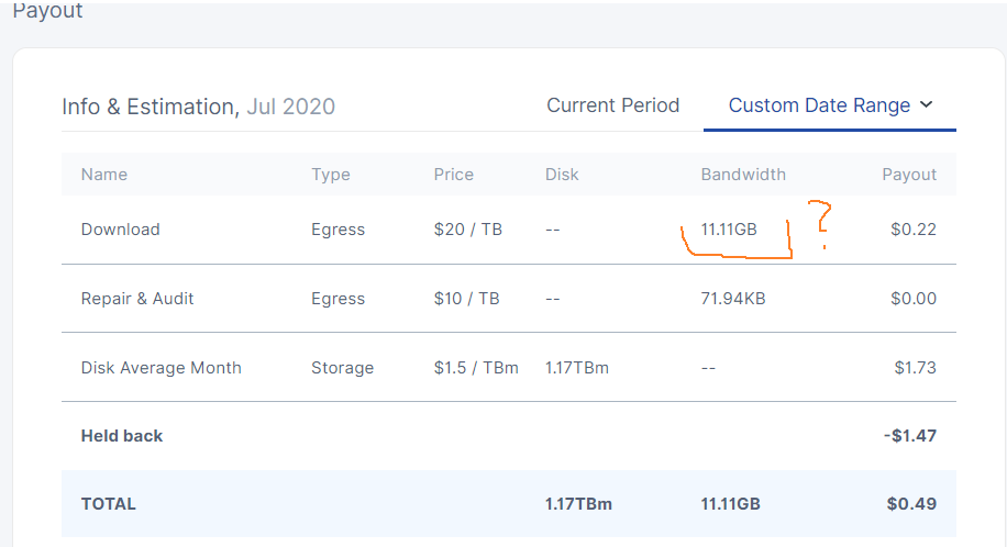

Is it possible that payout is not made at once?
Just got payout but it is not full amount - I mean dashboard was showing ~5$ for last month.
Earnings calculator also was showing ~5$ but now (when I check last month) it shows only that node earned ~2$ mostly for storing files (bandwidth is showing only 11GB) - earnings calculator (for last month) is showing 174GB

From your response I assume that it didn’t happened to you - discrepancy between earnings script and payout from tartigrade. (taking into account that there is held amount of 75% for now)
I am aware of held amount but this is a different thing - each tool shows different BANDWIDTH usage - and different TOTAL earned. egress amount - 174 GB (earnings script) vs 11 GB (what node shows)

sorry taking a closer look at your numbers, they do seem kinda odd…

11gb egress can’t be right or even close… atleast from the numbers you shared and from the numbers i would expect for just about any node… new or otherwise…
maybe try to reload the web dashboard… sometimes it won’t update correctly… then you have to refresh the browser, the button on the dashboard will not update.
anyways give it a day, check that you got paid the expected amount, the payout thing on the dash board is still kinda new… might be a bug somewhere…
Weird that the dashboard gives an incorrect number for the amount of egress.
My payment was coherent with the data on the payout dashboard.
yeah, I got the payment already and it is consistent with STORj price (~$0.19 per token) and amount paid ($0.49) for this node. (second node payout is too insignificant to have any impact)

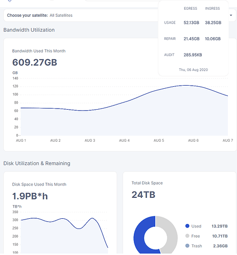

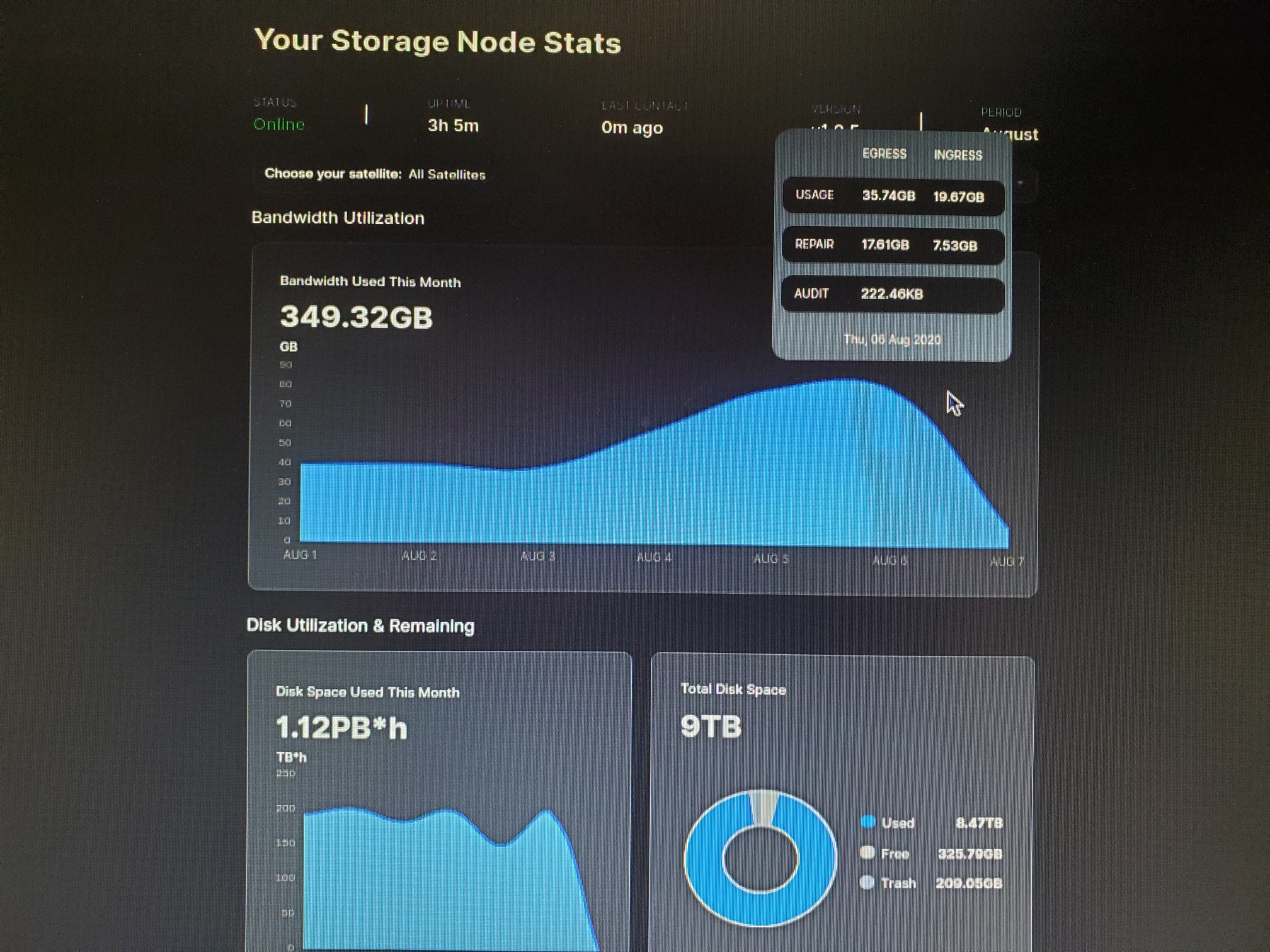

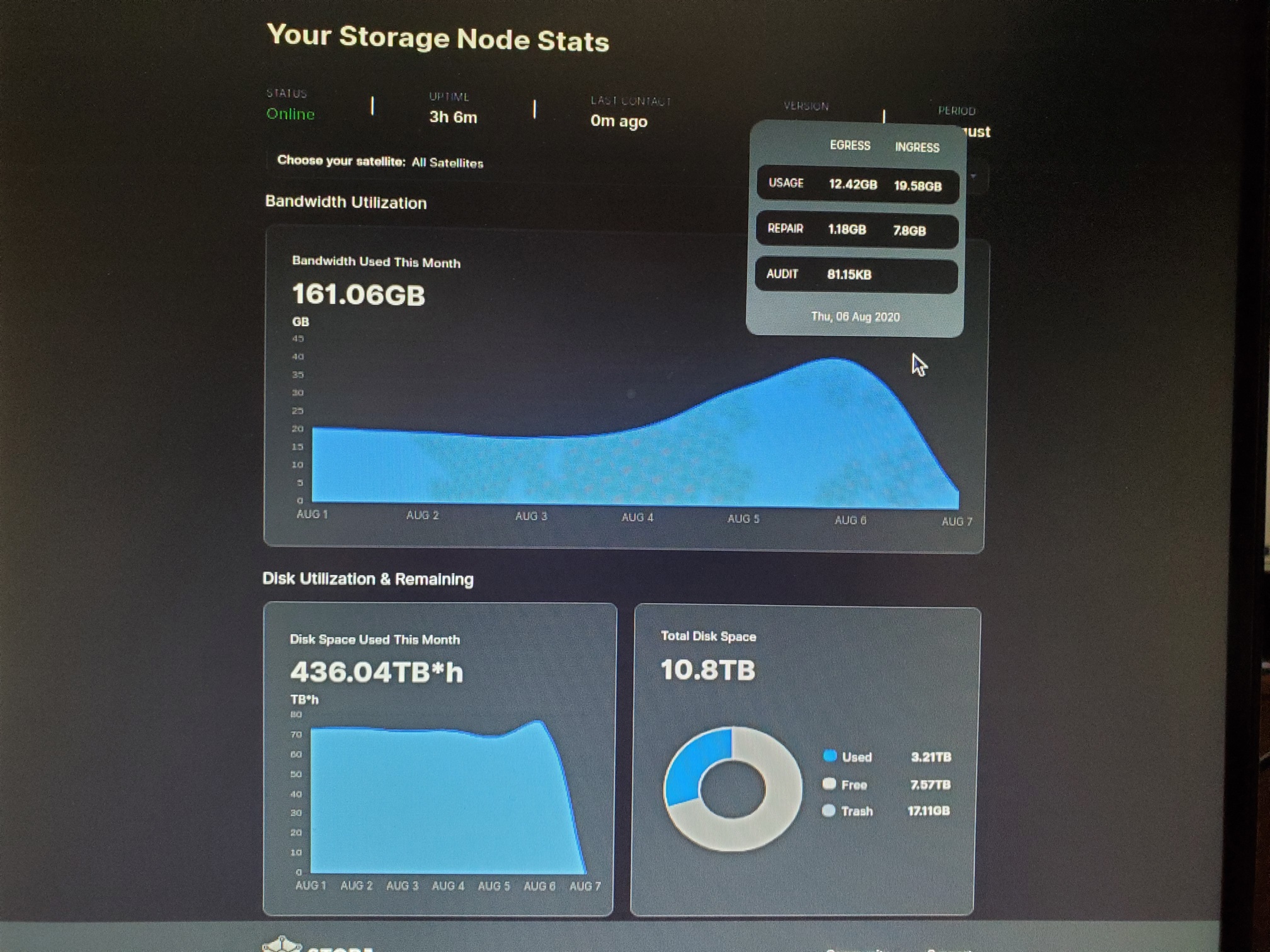

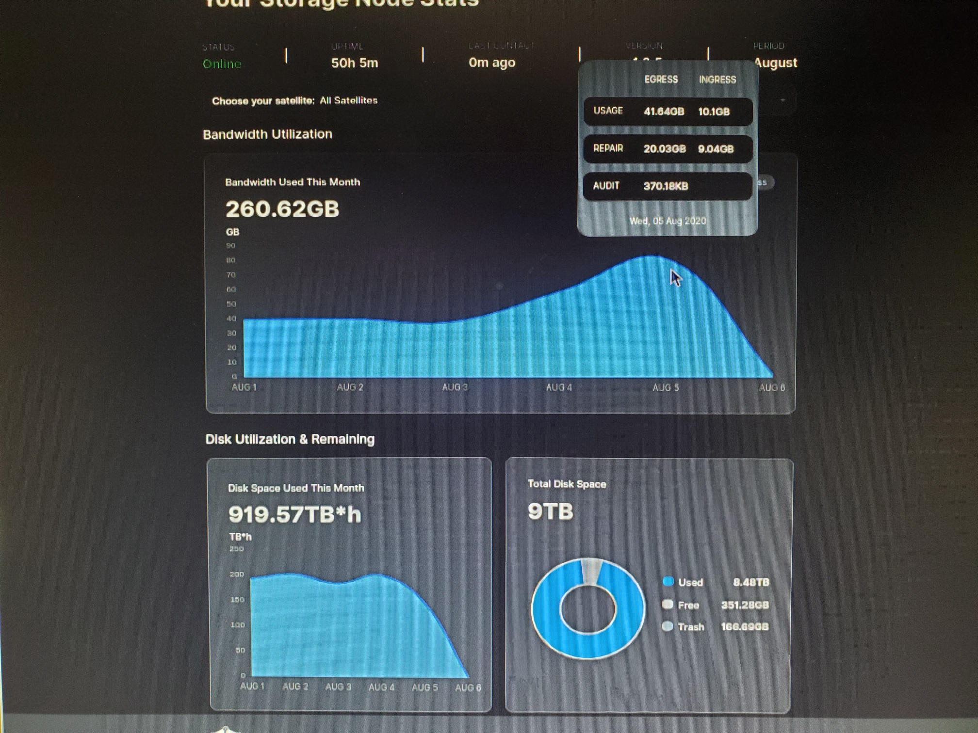

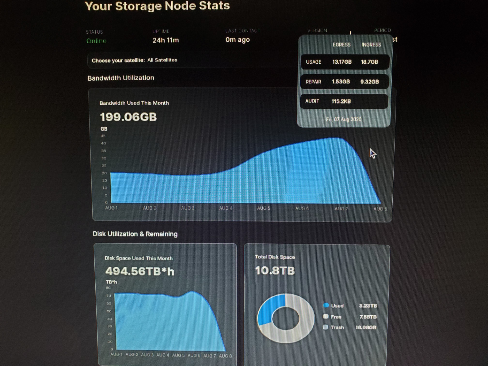

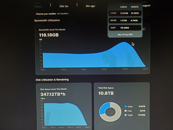

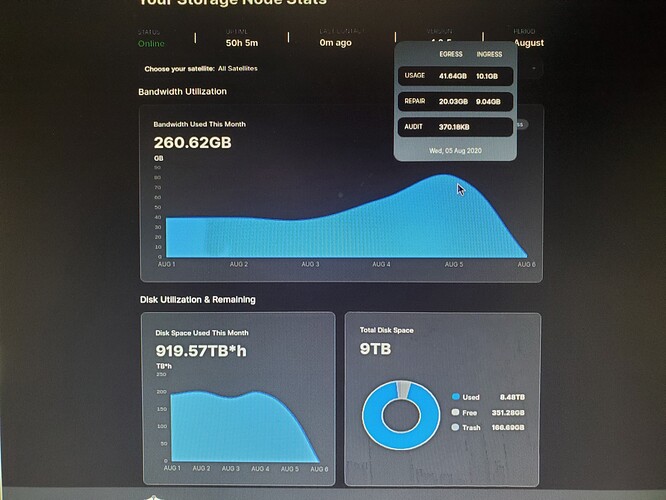

My node’s numbers
And it looks like most of the satellites are picking up the speed again.
not the europe north though.
