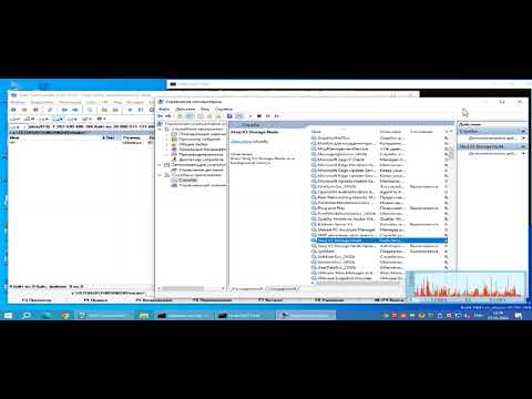

The problem only affects WINDOWS!
I recorded a video of how this happens!
Link to YouTube
