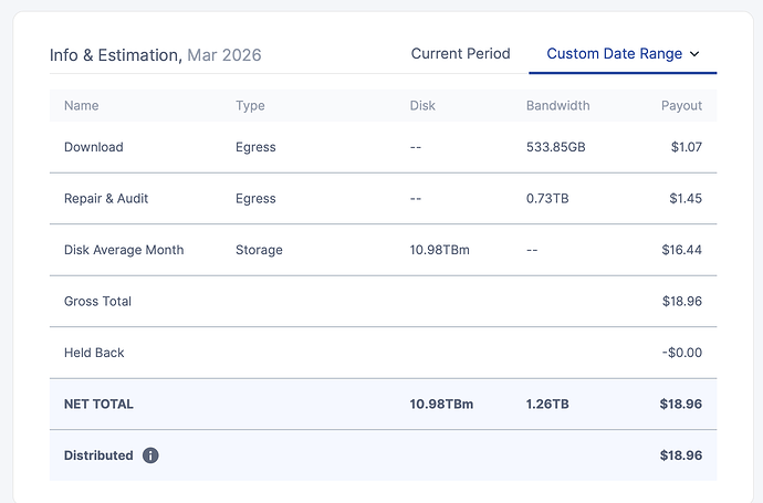

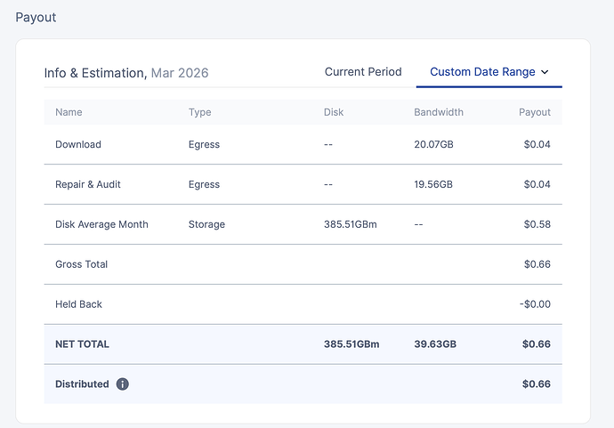

One of my nodes 12q3RdqkgSGEdK5y38YLpxFEVM5Va4smh4K9nS4NTnkW65cV2Ec returns bogus values for March payout via API and dashboard:

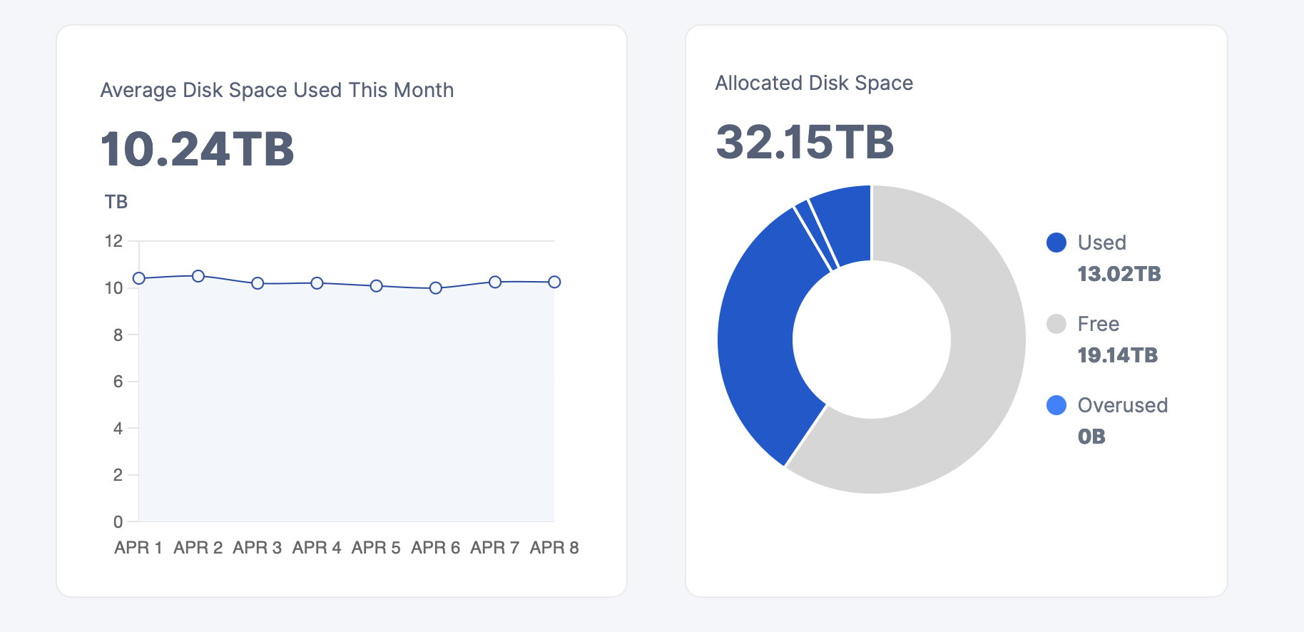

The node seems to be inconsistent about how much data it stores: 385 GB average vs 10+TB actual.
But
  1. I thought payouts are returned by satellites, not nodes, so even if node is confused about how much data it stores, historical payout shall be still correct
  2. Node reports correct stored size elsewhere in the dashboard, so there is something wrong with that historical payout calculation
Ether way, a bug .
Payout estimate is using GBm… :thinking:
Right. This makes it even worse :slight_smile:
It should have been 10TBm or so

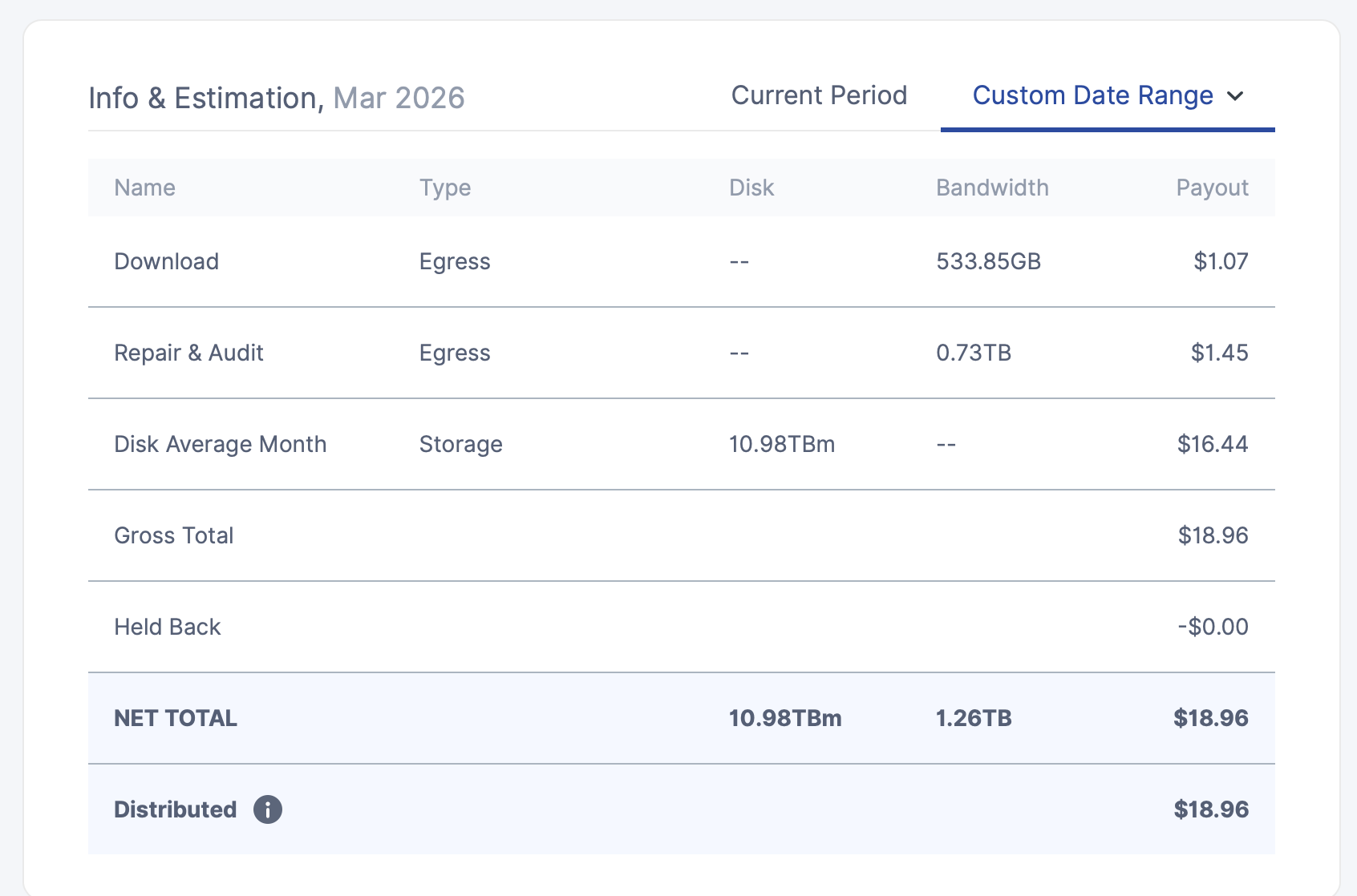

I now checked, node also updated what it displays in the dashboard.

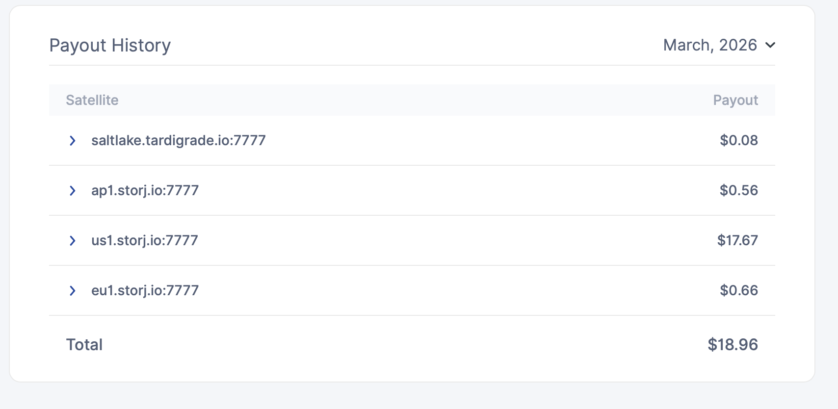

So it looks like maybe it did not receive updates from all satellites at that time; specifically, $0.66 matches what EU satellite reports alone.
So the bug is visual – node shall show in the UI that not all data has been received, instead of pretending partial data is complete.
