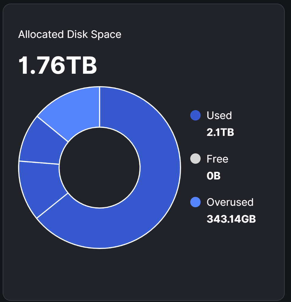

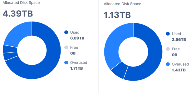

Hello everyone, today I noticed that twoof my nodes are showing the following:
Can someone explain what this is due to?

Same, some node updated to this and it is saying 0 free space in dashboard
Edit: this seems to work for a work around storage2.monitor.dedicated-disk: true
Thanks and can confirm, my nodes also stopped accepting new ingress, egress was working fine. I already had the following line but this wasn’t enough:

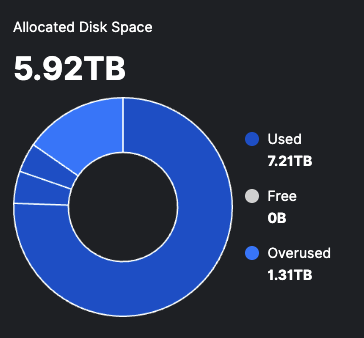

I seem to have the same issue, running it on Unraid.
Nothing changed in my config either, it was set for a few months already at 8TB.

I think you cannot, IMHO there is bug that node is taking remaining disk space as total capacity. See my other thread. Another of my nodes (4TB disk, so configured as 3.7TB)
df --si
# reports
storj2/data                       3.9T  2.2T  1.8T  55% /storj2/data
shows:
I think it match my theory that node use physical free space as declared capacity
