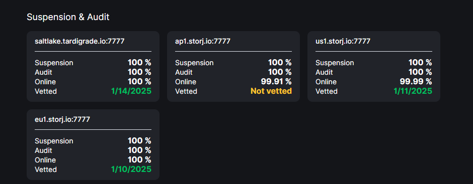

I have 17 nodes of which 8 are showing unvetted Satellites. Some are showing unvetted on 2 Satās and it always seems to be EU1 and/or AP1. US1 and Saltlake are fine.
The one above is the youngest node.

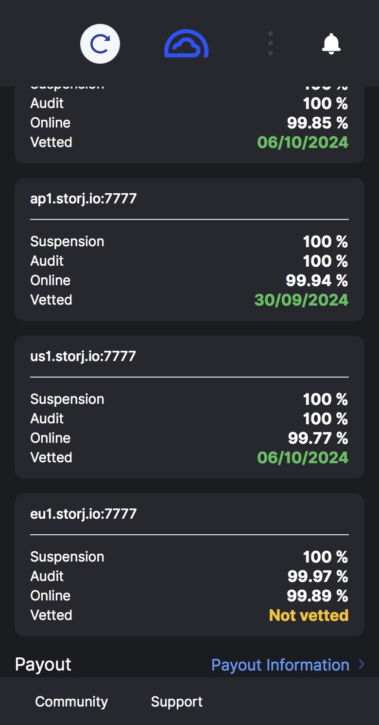

I run this storj node now for 12 months. The last updated added the vetted status on the dashboard. I see now that I am not vetted on this one? I have also almost no used space on this server.
All other say vetted and I store currently 9TB. Is this normal?
BTW: suspension, audit and online are all 100% on every server.
