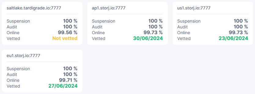

I had 7 out of 24 Not vetted now it is down to 2 of 24. The two remaining ‘Not vetted’ is both on saltlake.
All except one fixed as well.
Details of the missing:
12KiYpvzm9YwhJBx6LtQufCEae1zk42sAYDpX8FtnEAieeBV1k1
Not vetted on Saltlake does almost not matter. It’s around 5GB of data per node at this time :slight_smile:

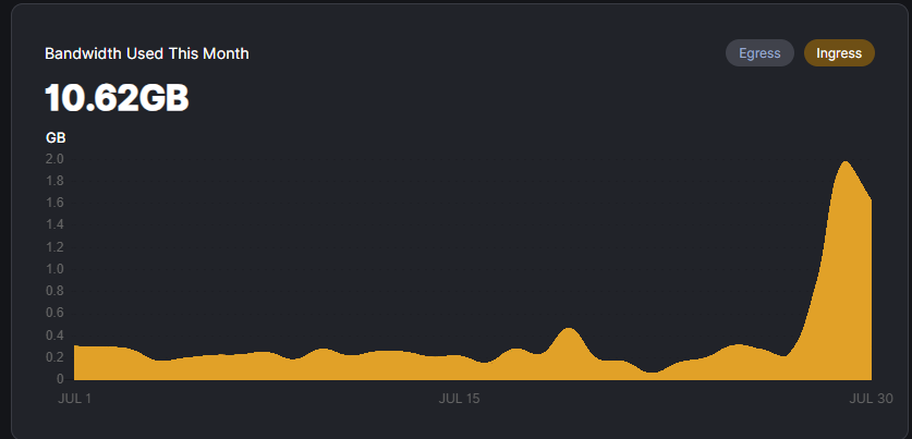

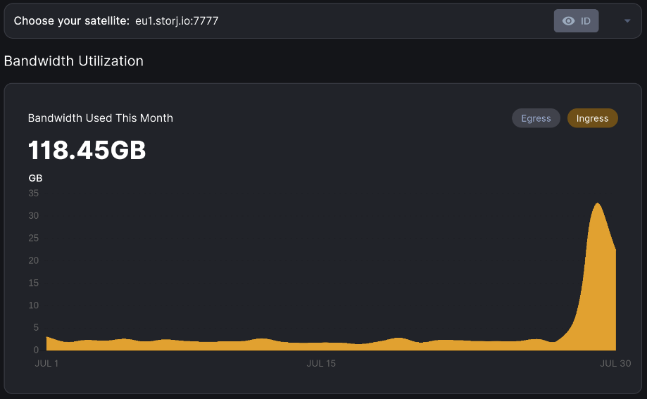

And may now be seeing more ingress from EU

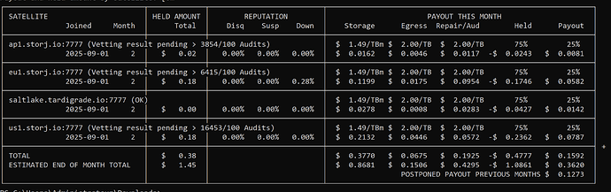

Currently i have satellite us1 not vetted, however by using the estimator.py script (Earnings calculator (Detailed earnings info and health status of your node, including vetting progress and garbage collection status)) i see that have done 10324/100 Audits.
Is there any way to fix that?
