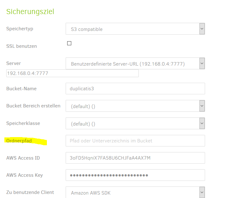

Do you have something in the path option in the Duplicati?
what do you mean with path
