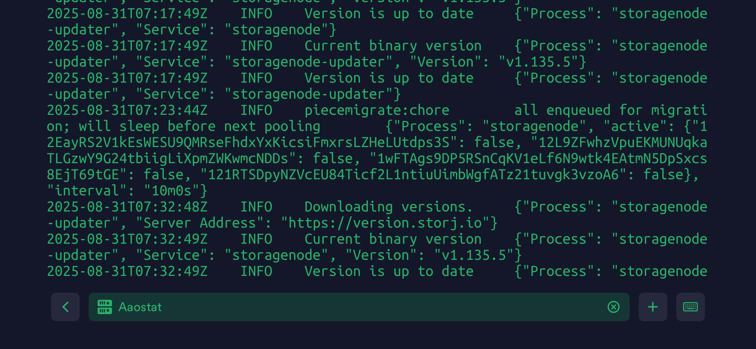

Some operators reported that they seen the migration started on their nodes, but they are on 135. I’m thinking that there were 2 formats of v 135 released, one format with hashtore on, one format with hashstore off… or the operators are mistaken.
This node
is 1.35.5

None of my 1.135.x nodes has started migration so far, and I don’t have an insides, is it started or not.
+1
1.135.x can work with both hashstore and piecestore code so this could be a hint of how it will proceed. My node too has the flags set at falsebut no migration yet.
