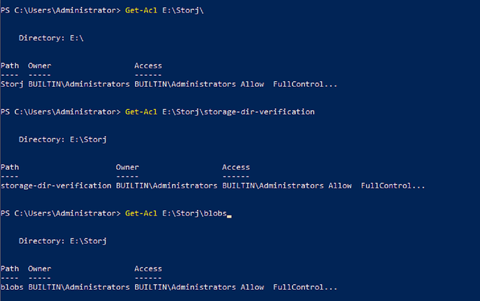

Please, show permissions (PowerShell):
Get-Acl O:\Storj\
Get-Acl O:\Storj\storage-dir-verification
Get-Acl O:\Storj\blobs

PS C:\Users\Administrator> Get-Acl O:\Storj\
Directory: O:\
Path Owner Access
Storj BUILTIN\Administrators BUILTIN\Administrators Allow FullControl…
PS C:\Users\Administrator> Get-Acl O:\Storj\storage-dir-verification
Directory: O:\Storj
Path Owner Access
storage-dir-verification NT AUTHORITY\SYSTEM BUILTIN\Administrators Allow FullControl…
Directory: O:\Storj
Path Owner Access
blobs NT AUTHORITY\SYSTEM NT AUTHORITY\SYSTEM Allow FullControl…
PS C:\Users\Administrator> sls “storage.path” “$env:ProgramFiles\Storj\Storage Node\config.yaml”
C:\Program Files\Storj\Storage Node\config.yaml:173:storage.path: O:\Storj\

I would guess something has happened to the permissions as my blobs folder has the same permissions as the main Storj and the storage-dir-verification.
Also the error points to a permissions problem - “CreateFile O:\Storj\blobs: The system cannot find the path specified.”
Not only on the blobs folder but other files and folders within O:\Storj\ so you should try adding ‘BUILTIN\Administrators’ - Full Control permissions on everything within the Storj folder.
I’m trying all the possible permissions for everyone …
lol, resetting these permissions takes forever …
The Storj folder and all subfolders and files should have permissions not for Administrators group, but for SYSTEM user, because the storagenode service is running under SYSTEM, not Administrators.
I would recommend to do not make Administrators as an owner, having this group as an owner could trigger the Windows UAC protection, but the confirmation screen would be hidden, because files accessed by the service (it has no access to GUI), as result the service will got an “Access Denied”.
So, please, made SYSTEM as an owner of all underlying objects under the Storj recursively. If you have a “CREATOR-OWNER” group in your access list - please, remove it recursively too.

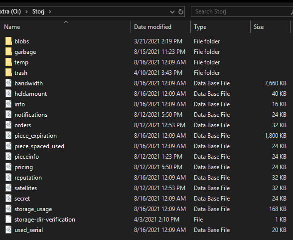

Please, show result of the command (PowerShell):
ls O:\Storj
Winner, making SYSTEM the owner of the Storj folder and all subs … Thank you for your time :slight_smile:
