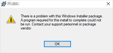

Hello, i just upgrade from Windows 7 to Windows 10, but i cant install storagenode, there is a problem with windows installer package
i try many things, sfc scannnow, windows updates, manually add service, nothing works
This is likely because of .NET framework missing ?
i have installed latest version 4.8.1? maybe need also an older version?
I believe this happens if you have remnants of an older install in the same location. Or you didnt uninstall it completely first.

But likely @Knowledge is right - you need to uninstall the software and delete the "C:\Program Files\Storj" folder before the install.

ok, i found solutiion, i pointthe storj base to another folder, so installed normaly and after i restore the old config, thanks all for the help and your time!
