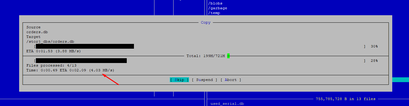

So, what’s the accepted way of doing it with docker? As I understand the paths in config.yaml are relative, so I probably need to mount the SSD under /storj/node/ssd and specify “ssd” in the config file?
I am not super familiar with docker.
I see, I think I should prepare short instruction how we can move DB’s with docker.
(I on docker too)
Please give me some time.
I think this should be a new topic so this can be categorized as SNO->FAQ
Yes, I agree, but I think this instruction for advanced SNO only, a newbie can kill their nodes…
Let’s ask @Alexey to review it and make a decision for the move or not.
