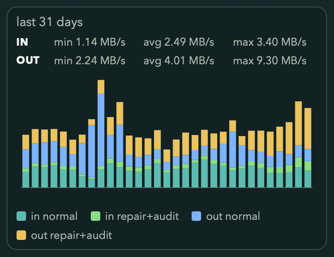

I don’t see any significant difference in the past month. Yellow is repair.
What is out repair and in repair?
I guess “in repair” are the pieces “moved” to your node from other ones. But what is “out”?
The repair egress from their nodes.
We adjusted RS numbers several months ago, so now it’s noticeable.
The repair workers downloads missed pieces.

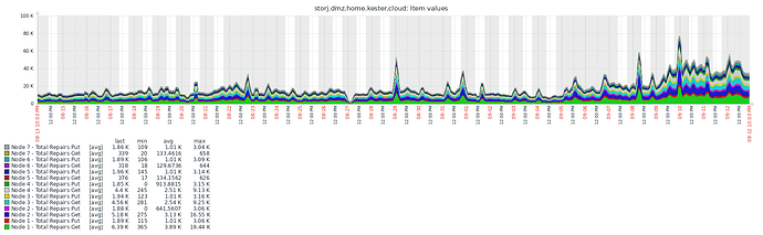

This is the count of repair get and put operations, not storage volume so it may be skewed, but the count seems to have increased a bit on my end. Going back even a few months I don’t see a jump quite this high.
I’m not sure if this is actual node departure or the RS changes mentioned, my nodes all seem to be both taking in and sending more repair traffic.

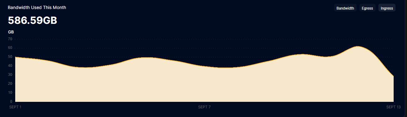

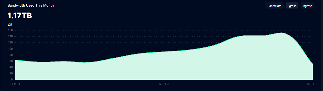

I also see a lot of repair egress these days. Repair ingress is a bit higher then usual, but not by much. I expected a lot more data with big SNO’s leaving the network.
Egress:
Ingress:

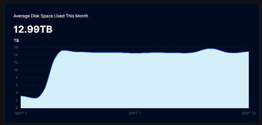

Average disk space is stable (nodes are fully migrated to hashstore)
