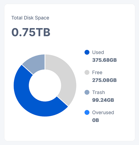

after the migration to hashstore there is a significant difference in the Used Space on the Drive and on the Dashboard.
As the Trash is in the same log-Files as the Used you need to add both.
So 375.68 + 99.24 = 474,92 GB.

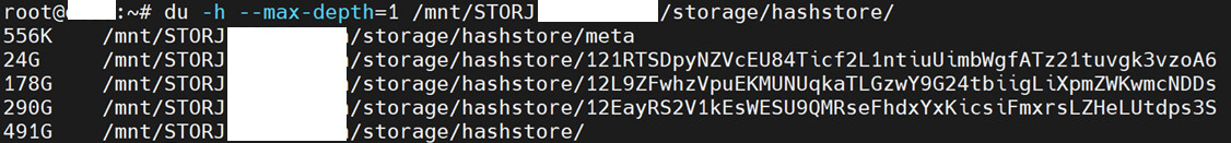

When I type du -h --max-depth=1 /mnt/STORJ-node/storage/hashstore/ it is showing the Used Space in GiB:
It is there 491 GiB.

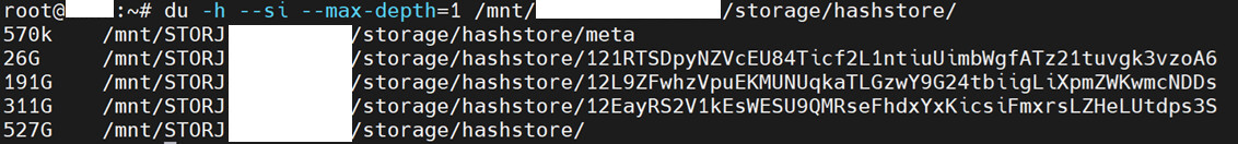

But with du -h --si --max-depth=1 /mnt/STORJ-node/storage/hashstore/ which is actually GB and not GiB it is showing:
A whopping 527 GB on the disk.
So its:
Dashboard:   474,92 GB
du -h:       491,00 GiB
du -h --si:  527,00 GB
It’s on all hashstore. On a fast SSD and renewed used_space_per_prefix.db.
