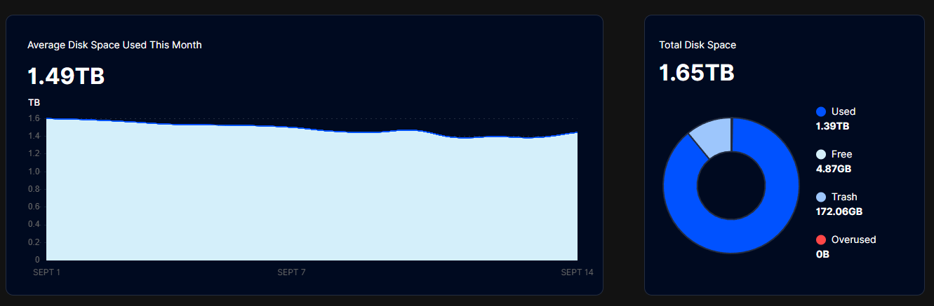

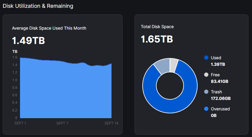

Hi. I noticed differences in free space report on node/multinode dashboards. Node fully migrated to hashstore.
Multinode reports correct usage, while node reports +250gb free.

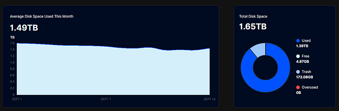

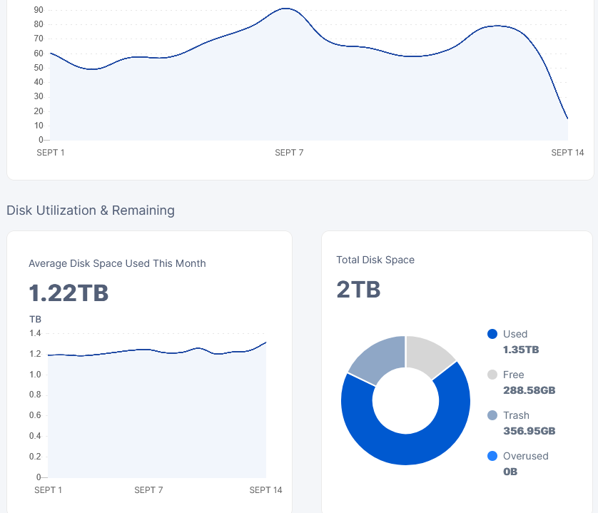

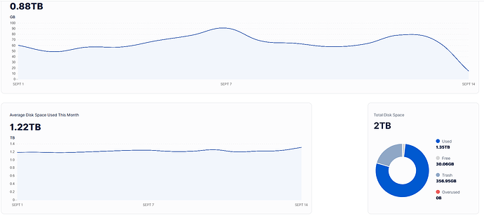

8 nodes finished migrating to hashstore, and I’m seeing the same issue on the node dashboard while multinode dashboard looks fine. I thought there was a problem with my nodes, but apparently I’m not the only one.
Did some troubleshooting, but so far I could not find wat the problem is.
When a node is almost full (5GB free space) ingress stops for that node, while the node dashboard says there is still +80GB off available space. So that’s still working, but the dashboard is having some troubles on these 8 nodes.
Multinode Dashboard
Node dashboard

Recreated all database files, wrong numbers on dashboard remain the same(
All calculations correct, except free space. Multinode dashboard show correct numbers. I dont think this is glitch in database.
