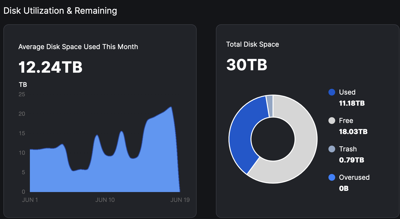

Hey all,
I’ve been running my node on TrueNAS scale for nearly a year now with minimal/no issues. Unfortunately, I had an HDD fail and am currently resilvering. This shouldn’t really impact the storage capacity much but may impact some server performance until finished. One thing that I was just warned about is that the amount of physical space that I’ve reserved for Storj is almost at 95% capacity.
I’ve allocated about 30TiB to the Storj node that I am running:
When I look at the Storj Node Dashboard the disk space used is MUCH lower:
I’m not sure why there is such a huge discrepancy, but is there any way to clear the unused on-disk space to make room for more usage? Or is there some way to get Storj to recognize the space it uses on disk?
You need to make sure that the used-space-filewalker is successfully finished for all trusted satellites, you also need to remove data of the untrusted satellites (How To Forget Untrusted Satellites).
This is mean that the filewalker is failed to complete the scan due to slowness of the disk.
Since this is Windows, then you need to stop the node, check and fix errors on the disk, then perform a defragmentation. You need also to enable an automatic defragmentation if you disabled it (it’s enabled by default). You may also disable 8.3 names: NTFS Disable 8dot3name and atime:
After that start the node again and make sure that filewalkers are not failing anymore.
You need also make sure that you do not have errors related to databases in your logs.

@t0x @gingerbread233
The suggestions are the same, you need to have all filewalkers finished their work, remove data of the untrusted satellites and make sure that you do not have errors related to databases in your logs.
