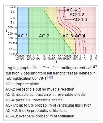

Again people, and this goes to anyone with all due respect: at 45mA through your heart, death starts. It is an inverse relationship of mA vs time alive: The higher the mA, the less seconds you have left.
Yeah, time and current choose how dangerous something is. There are charts for this:
