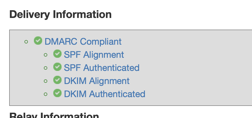

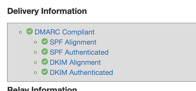

Do “Show headers” on that email (or whatever gmail calls it) and paste them here: Email Header Analyzer, RFC822 Parser - MxToolbox
It shall check DKIM/SPF/alignment. Ideally you want to see somethign like
If not – down lower on the page will be explanation, of what specifically does storj need to fix.

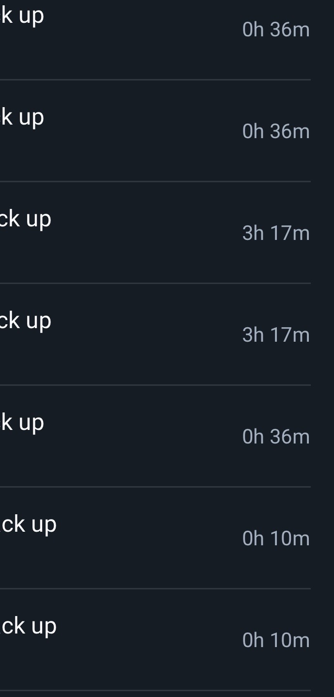

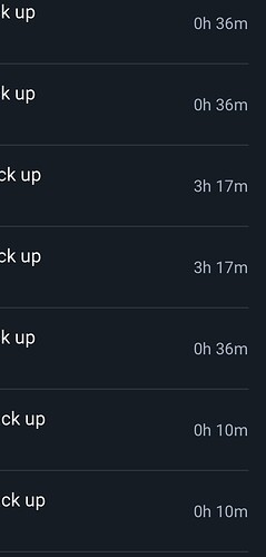

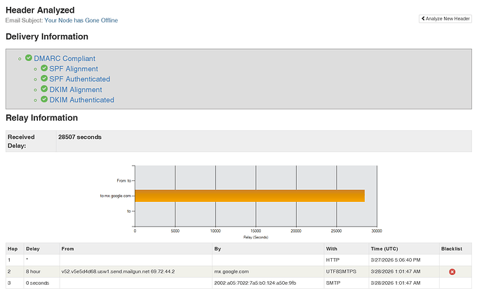

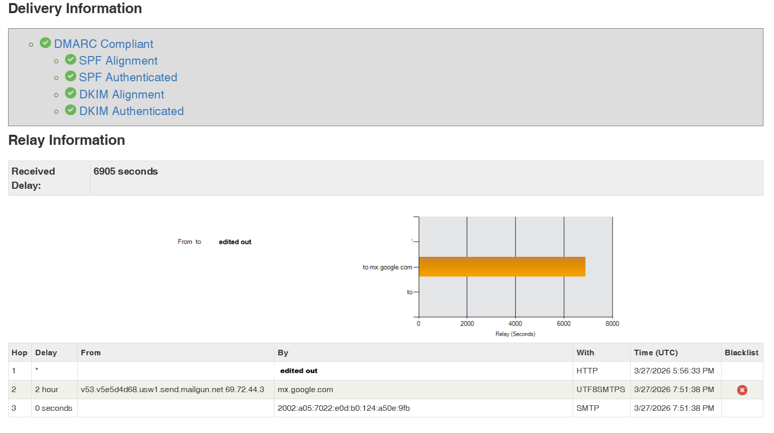

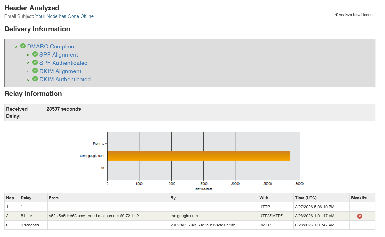

So, I see a blacklist mark on the same field on both headers and a verry big delay from the sender to receiver, if I interpret this correctly.
I edited out the fields were it sais edited out, it seemed like a key or something, on the 1st email, but the second email already had blank fields there.
So it seems that they were sent at the right time, but a verry big delay made them be received in revers order; like they stood in line at 2 different checkpoints. One moved 4x faster then the other.
the flashbacks… :smiley:
So, Gmail heavily delayed acceptance of both messages from at least two Mailgun relay IPs.
Storj shall pull Mailgun logs for affected messages and inspect Google’s raw SMTP replies for these two IPs / this stream.
Maybe they have bad ips in the pool storj happens to be served by.
Would be interesting to see if this is gmail specific issue. But likely it’s malgun being mailgun. I had issues with it as a private individual, and moved to Amazon SES long ago. Maybe storj shall consider doing the same.

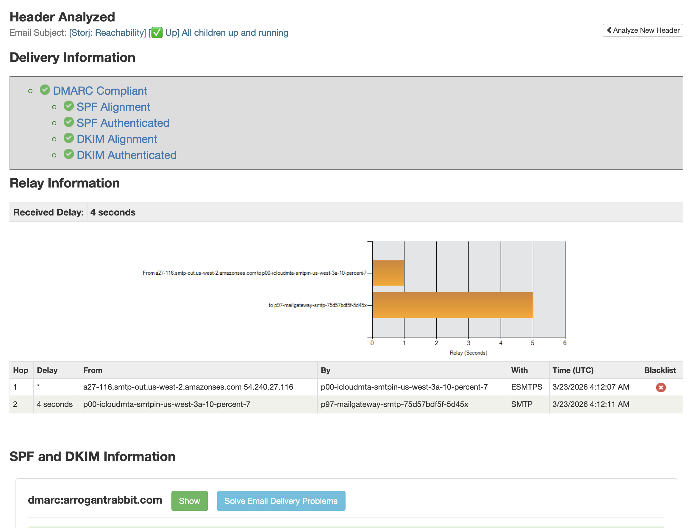

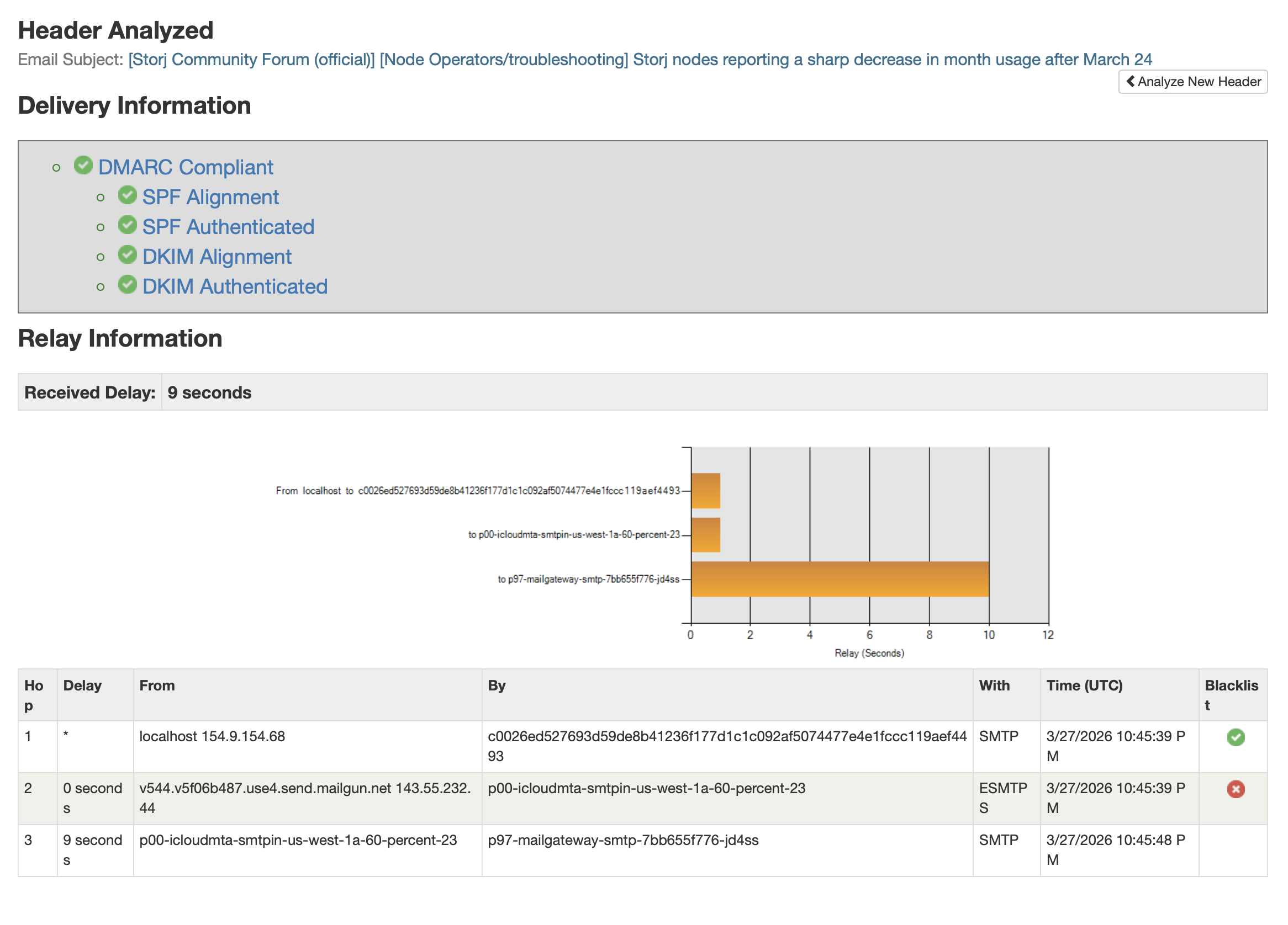

Are you receiving forum emails? Do they also experience similar delay?
this is what I see with normal forum notification email
And this is how Amazon SES deliverability works (from my monitoring solution in this case)
The conclusion and course of action for storj is obvious. Not only MailGun is vastly more expensive than SES, it’s also demonstrably shittier, on at least two accounts, and I remember seeing references to email deliverability issues on this forum more than once before.
It’s one of those cases, where it’s not what you pay is what you get, it’s WHO you pay is what you get :smiley:
