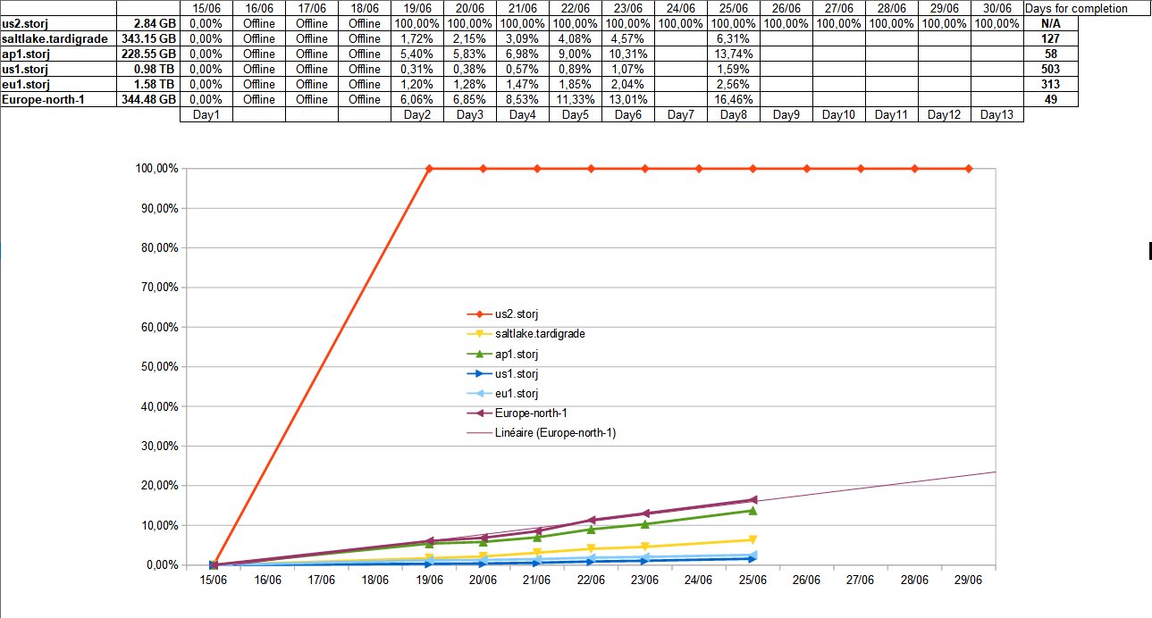

Hello.
In my case, graceful exit may be lasting hundreds of days, as shown in the following spreadsheet.
The second day, i had my fiber optic disconnected in the street wiring cabinet, and has been reconnected three days later by my ISP.
Is this the reason of the slow speed ?
I cannot wait as much to free some space in my server.
Do you suggest to change settings ?
Thank you.
GE will pick up speed faster and faster. Just keep the machine online. On one of my nodes, after 24h, I had like 24% completion, after 48h, like 60%, and in less than 3 days was done. I did only 2 sats, though.
Thank you for your hopeful reply, but my today’s update don’t show any acceleration, with 500 days to exit US1.Storj. The curve remains hopelessly and absolutely flat.
I’m afraid that if nothing changes by the end of the month, this will turn into a very ungracious forced exit.
