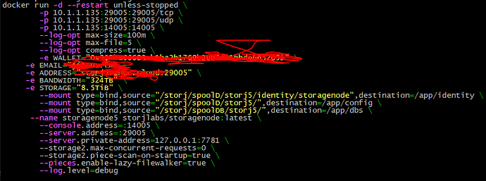

Configuration for launch
I didn’t change anything in the configuration.

Perhaps your docker network configured to the host mode, not the bridge mode (I think so, because you also changed the private address), in that case the listening address for supervisord is already occupied, you need to change it, see
So, you need to switch to a private port by specifying SUPERVISOR_SERVER=private_port:
docker run ... \
-e SUPERVISOR_SERVER=private_port \
--name storjlabs/storagenode:latest \
Maybe public_port may work too.

You cannot provide a port there, only change the mode:
  • unix - the default, it should use a socket
  • public_port will bind it to 0.0.0.0:9001
  • private_port will bind it to 127.0.0.1:9001
If you use a host network, then likely the public_port mode will not work, because it’s directly exposed to the host, and there could be only one with such number. But the private_port mode should work for multiple containers (the localhost (127.0.0.1) is still isolated as far as I understand).
The other way would be only to build your own image based on an official one and replace the port with a variable to be able to provide it for every container. And use this custom image instead of the official.
Thanks!
I thought it was a port reassignment, not a mode switch
It worked
