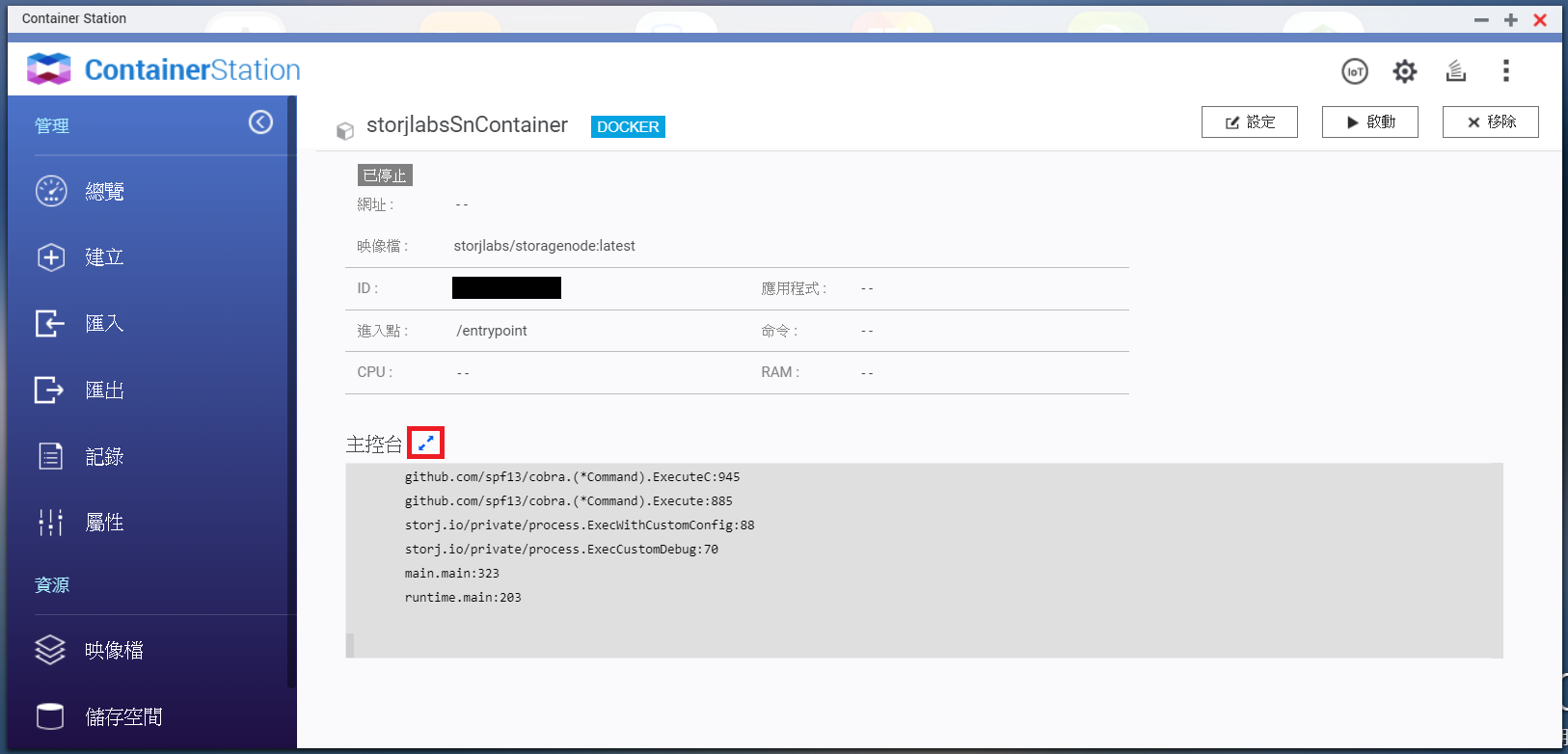

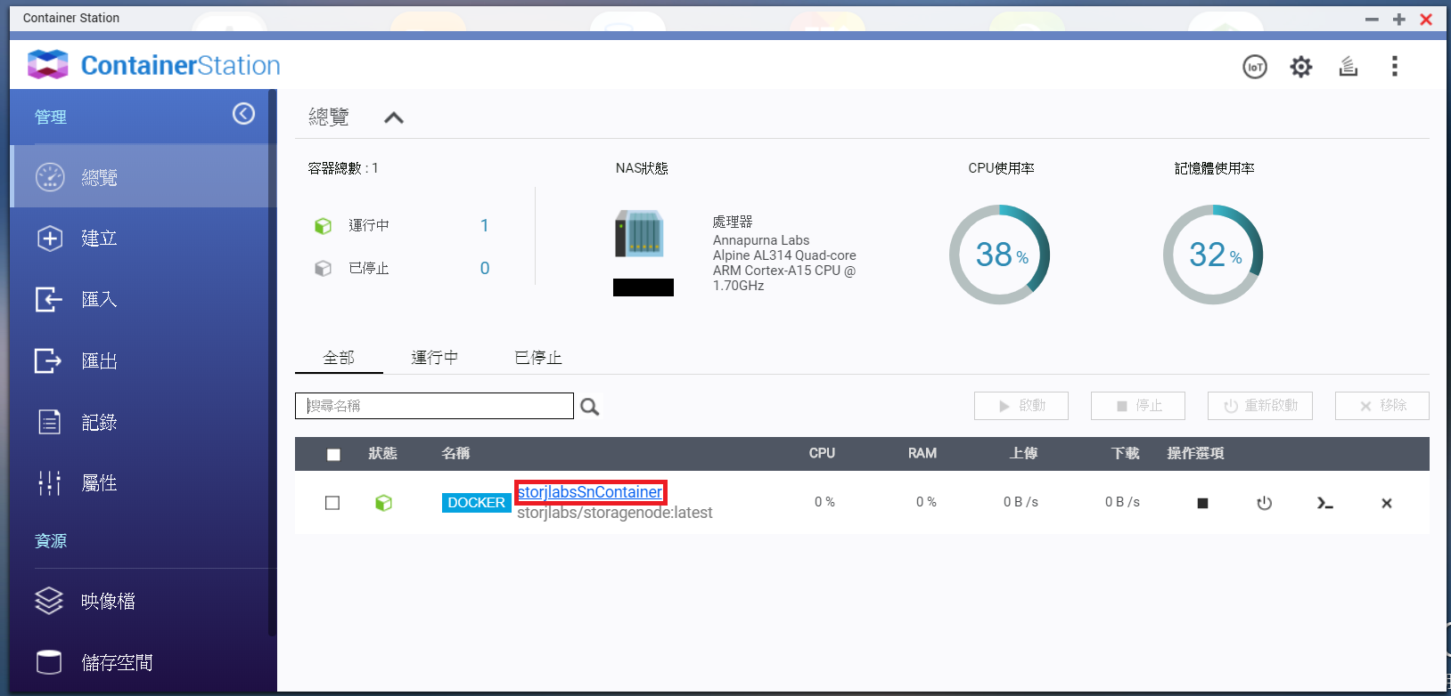

I guess your problem is the same as mine.
you can follow the following screenshots to get the log.
just click the red square side.
Hi qookoo,
Indeed, same problem!
