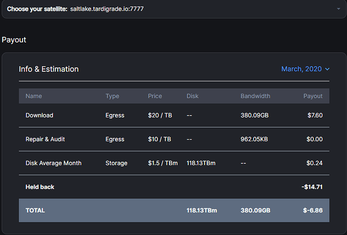

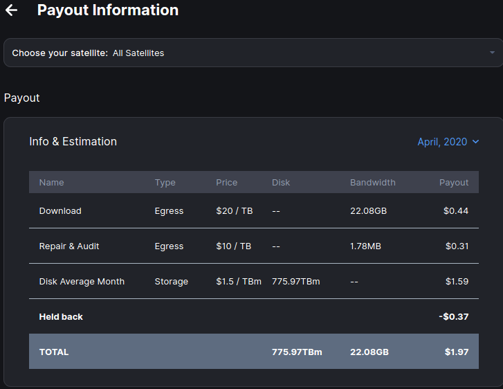

Neither number is even close to reasonable. For one, the dashboard seems to display the TBh number, but with the TBm unit. Strangely enough it displays the right number for the current month.
Second, neither payout is anywhere close to reasonable for storage, since you’re only paid $1.50 per TB stored on average.

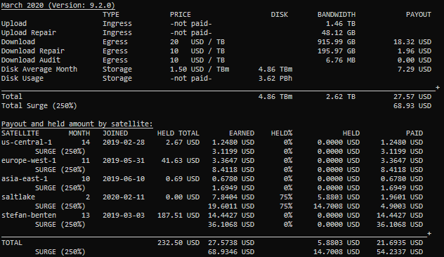

Since part of January was paid out in February, I’ve given up on trying to understand those months payouts. And since April isn’t entirely done yet (at least my node doesn’t have paystubs for April on stefan-benten yet) it’s probably best to compare March for now.
Definitely some weird stuff going on. All numbers are shown without surge applied, except for the held back amount, which is after surge. The total seems to be based on these mixed numbers as well.
The surge isn’t displayed at all on the dashboard, so no real way for SNOs to know why they got more.
The funny part… if you look at saltlake, the discrepancy between surge applied and not applied leads to a negative income.
