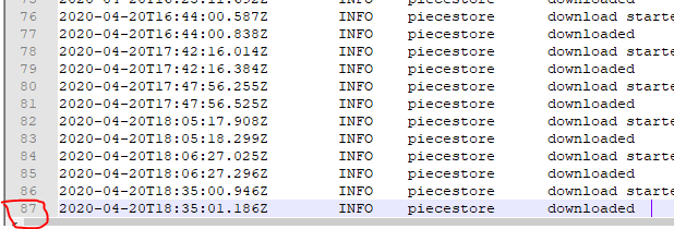

Hello, so I checked the forums today and noticed there was a new satellite added. I decided to check the audits for the new satellite on my node and I found strange that there was 1 failed audit. I went ahead and checked my log files but I don’t see any failed audit on it. Can someone point me to where I can look for this failed audit. Note, I have all my node logs since it first began.
Picture of log file
You should add failed to that grep command to catch that log entry.
I believe this to be an error in storj software, below is my logic for this statement. If I am completely mistaken, what would be the correct method for finding the error. Adding failed to the grep command produces no results.
First, I search for all audits done by this new satellite, whether failed or not with command "cat /mnt/storj/node.log | grep “AUDIT” | grep “12rfG3sh9NCWiX3ivPjq2HtdLmbqCrvHVEzJubnzFzosMuawymB”
My logic tells me there should be an even number of entries, one when the audit was initiated and the second when the audit either passes or fails. In my log files I have a total of 87 entries so definitely something is wrong.
Looking through the log I find that there was indeed an audit that was started and never finished
Now I just go through my entire log file and look for all mentions of this piece. It shows when I first got the piece and when and audit was attempted on it but never finished.
Lastly I search if the piece exists in my hard drive and it does

We would need the NodeID to find it in the logs.
ID 122PeurKoiakUWXjgixZVCp5MMoS8PSt6YAzetGmauZhtaui6WX
T: “2020-04-19T19:33:30.321Z”
error: “usedserialsdb error: database is locked; piecestore: (Node ID: 122PeurKoiakUWXjgixZVCp5MMoS8PSt6YAzetGmauZhtaui6WX, Piece ID: B3YNWPKVHMXXOSNXIXBYHIAGTJQWO334MKFGQUE6VY5U5WKSKM3A): usedserialsdb error: database is locked”
so database locked is audit failure?
It falls under the category “unknown audit errors”: Design Draft: Storage Node "Suspended" State
So nothing to worry about other than the 98% Audit rate right now on my dashboard T-T, thank you for the information.
