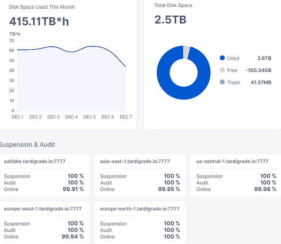

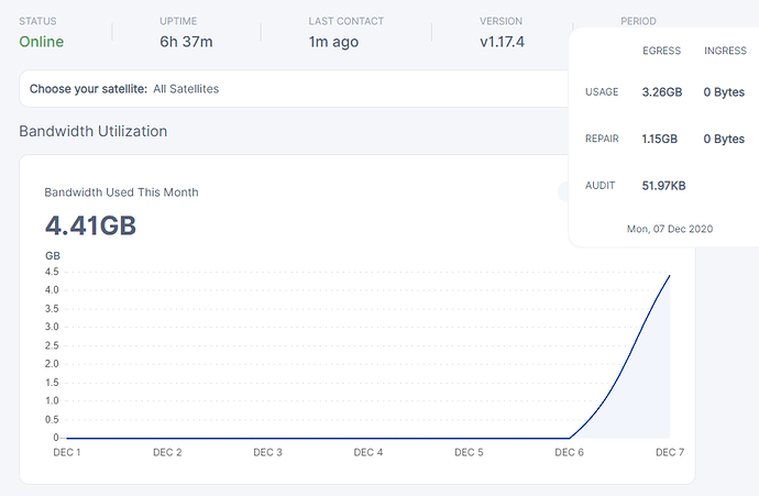

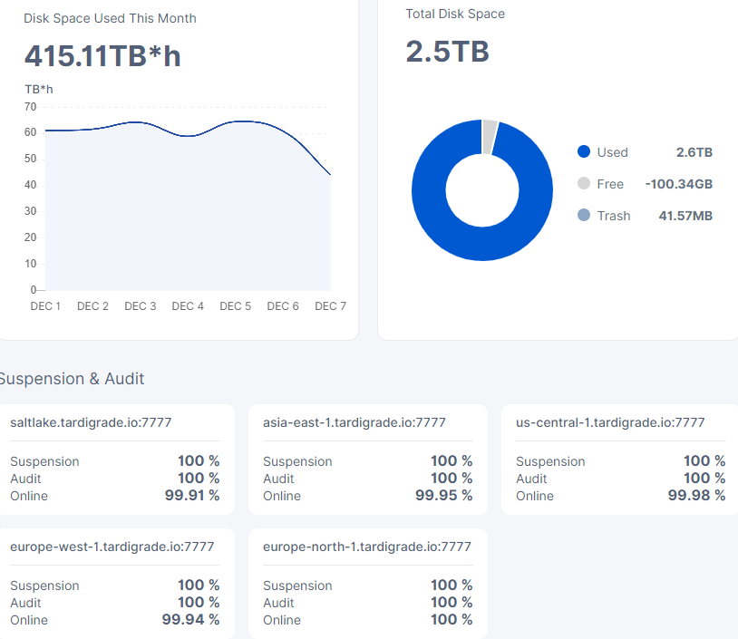

With the new month I don’t see traffic from the dashboard and after a few days looking at the log I discovered why, the bandwidthdb was malformed. Now I fixed the db and everything works but I’m curious, what has corrupted the database with the end of the month? And in this period the reputation of the node has decreased or from the satellite side everything seems ok? Do I get paid for the traffic of these days?
