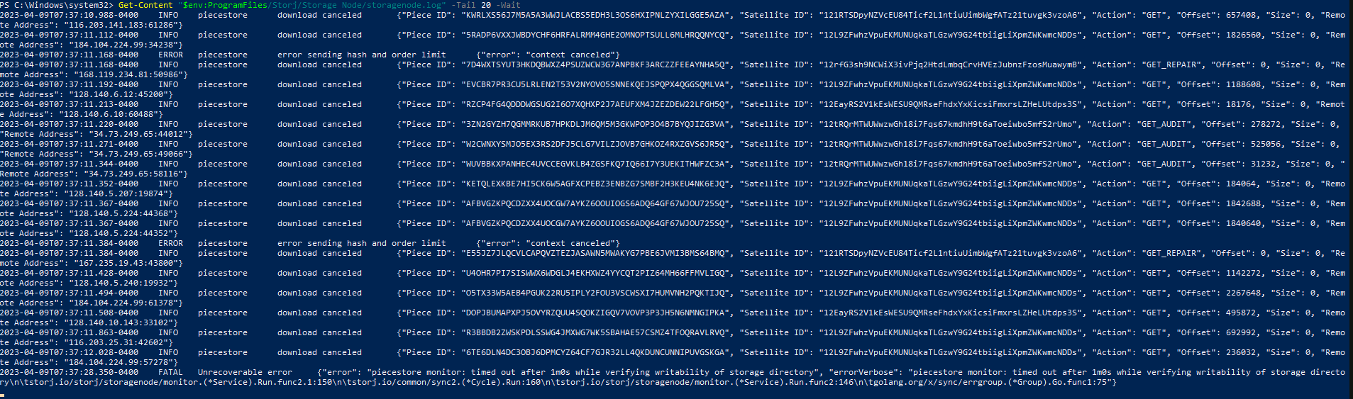

Fatal Error on my Node / Timeout after 1 min
No, it’s only one. Just it takes several messages to notify what is going on and the final one - FATAL.
Yes, seems it really has a hardware issue. But luckily it is a write timeout.
Please try to increase it to 2m30s.
ok, if i have the next time-window free (maybe next week) i will move the node to a much more powerfull pc. downside its wireless connected via wifi-ax.
anybody knows a good guide to move to new windows-os hardware?
think it’s quite easy since the disc is usb3.0, but how to install storj service and transfer safely?
The more powerful hardware is not required. We need to figure out, what’s best timeout for your setup.
So, please just adjust the timeout, save the config and restart the node.

So i tested with 2min timeout : no difference. node crashed nearly instantly.

writes, same as with 1min but with 2 min lastone with 1 min again, after i reedited my added lines with notepad++ and setting loglevel to error

You made a comment to change "storage2.monitor.verify-dir-writable-timeout: " for slow nodes as a potential fix. I just went into my config file and it looks like this is already set for 5m0s, but the log file indicates that it timed out after 1m0s. I don’t understand why it timed out after 1m0s.
