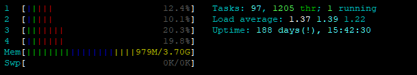

But my rpi4 is with all that heat and it runs great @5watts of power.
