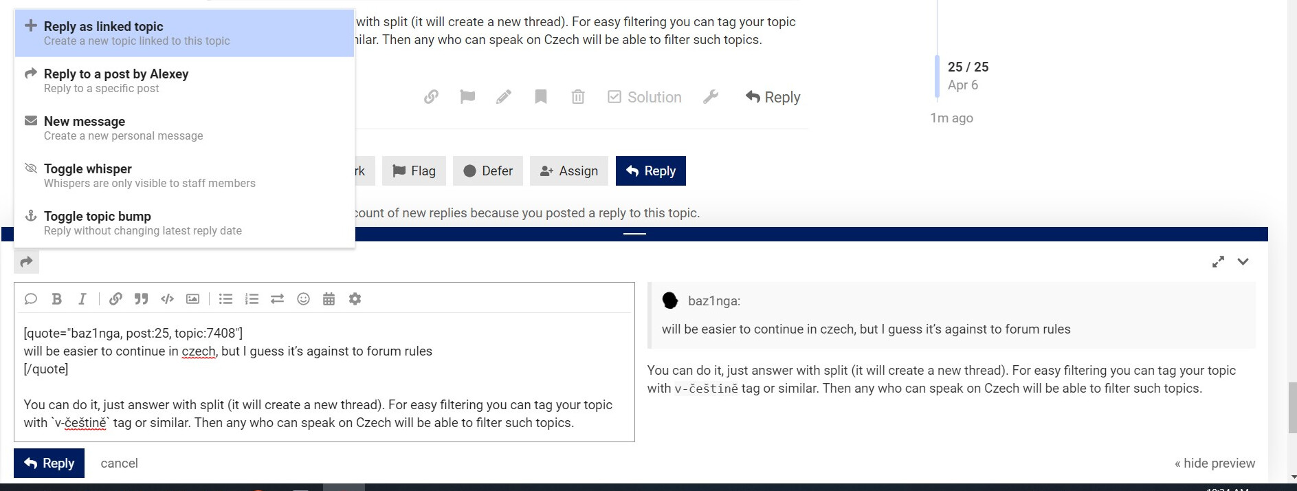

You can do it, just answer with split (it will create a new thread).
For easy filtering you can tag your topic with v-češtině tag or similar. Then any who can speak on Czech will be able to filter such topics.
Or moderators can split it later
