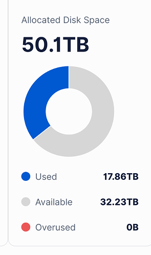

Interesting! I finished migrating 3 nodes and there was no problem with the free space. The dashboard show the correct occupied space during and after the migration.
I believe there were some code impruvments since few months ago.
So I didn’t need to delete that db.
may be you didnt restarted node during migration this time
I’m not sure of this, but maybe.
I didn’t, but I don’t know about updates.
