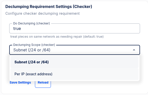

While you are at it, you may try multiple servers with different pricing range, eg: $1.5, $1.2, $1, 80¢, etc.. For example: I might set 80TB for $1.5, but after sometime without customer, I’ll split 30TB to $1.2 server, of course if it too low, I won’t border. Let see where demand meet supply. May also get rid of /24.
getting rid of the /24 requirements is also in my plan.. its simply to strict, but i plan to add an option so that nodes inside the same ip(address) dont get the same data
ie the same idea as /24 but not as strict

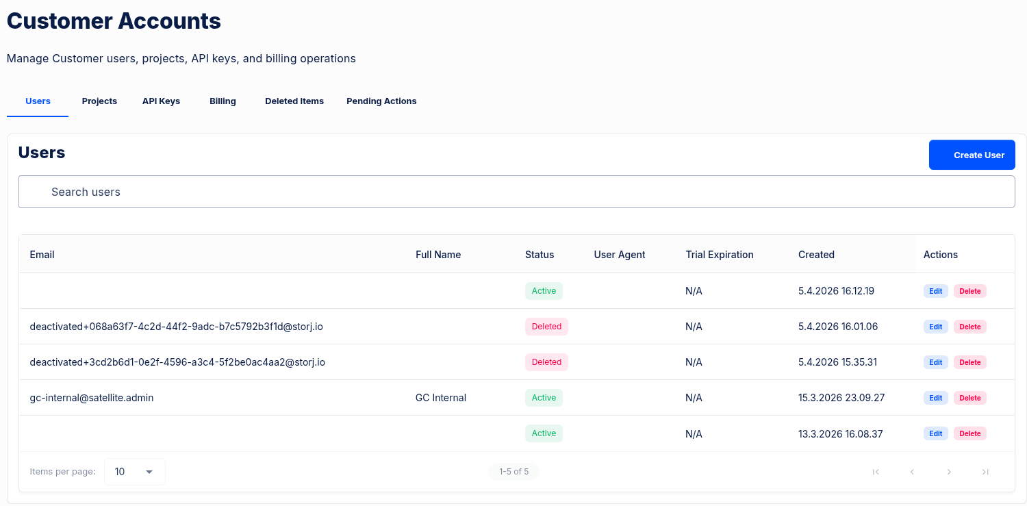

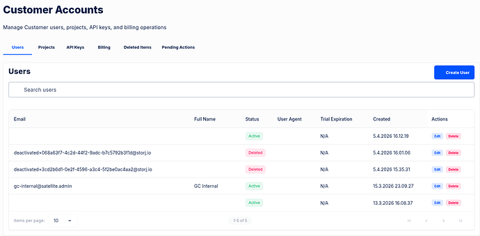

landing page after this is customers accounts:

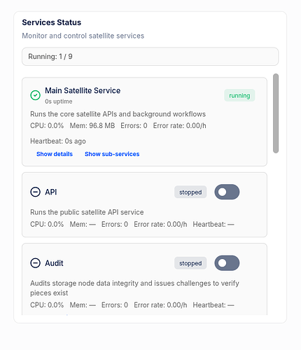

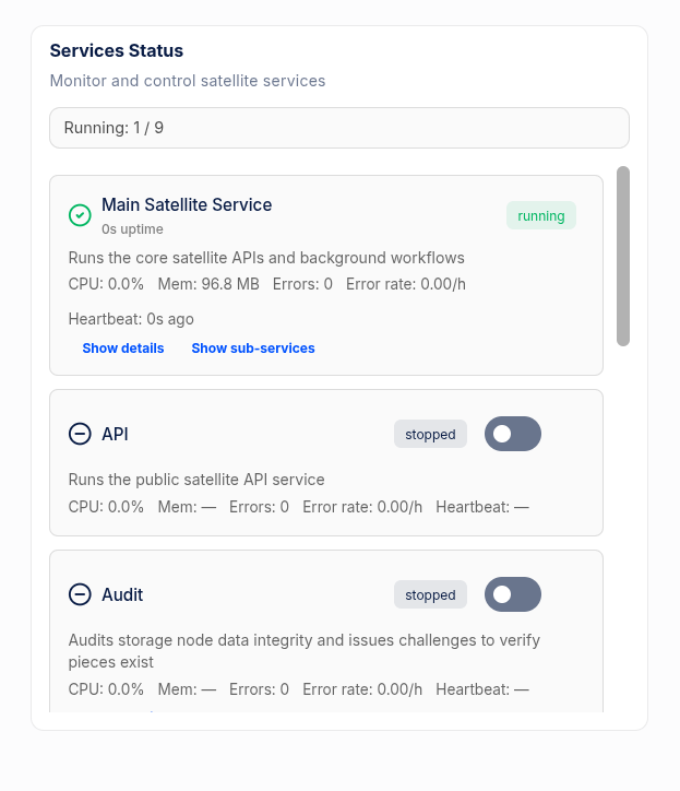

above that in side left hand sidebar/menu i also have a small services status thing that allow me to start and stop the different services the satellite runs

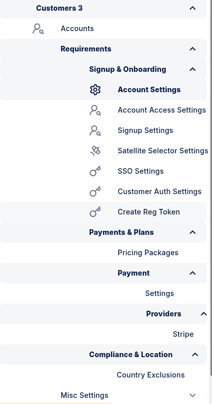

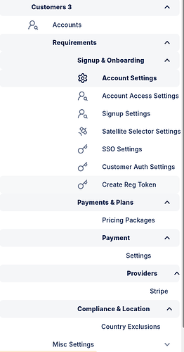

now all the settings i think and assume concerns the customer looks like this:

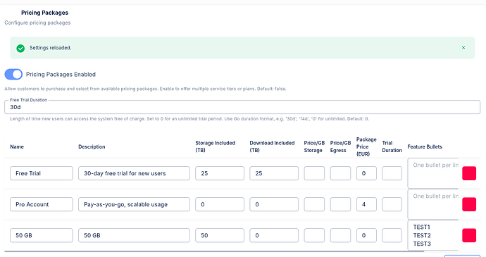

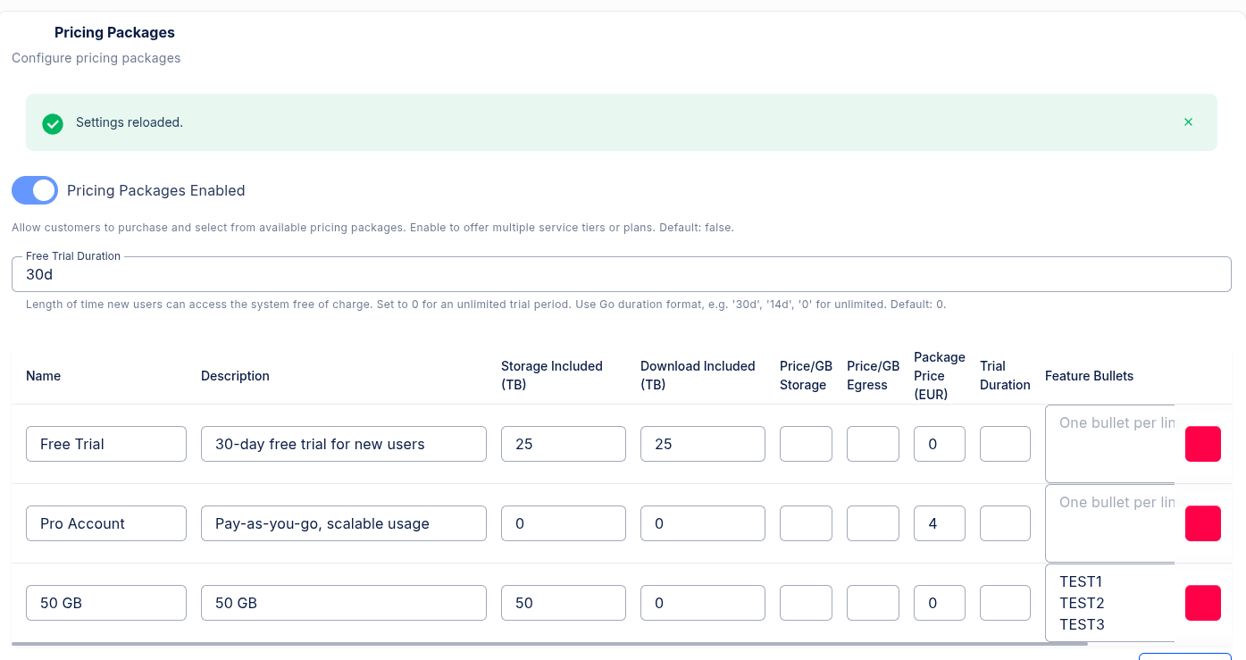

there are far to many to show at once, but the most important one is pricing packages
this allows to setup “packages” the customer can upgrade too
below it i have stripe that is used to collect money from the customer
now the most important one you think about is the thing that does check /24 requirement
i decided to use ip-api.com when a storage nodes contacts the satellite the satellite knows where its located, and the satellite can either do as storj does where the same data will not be sent to the same /24 segment or it will not be sent to the same address so the old option is still there
but as i and many have said, why should the guy next door be punished because i have a node or the other way round

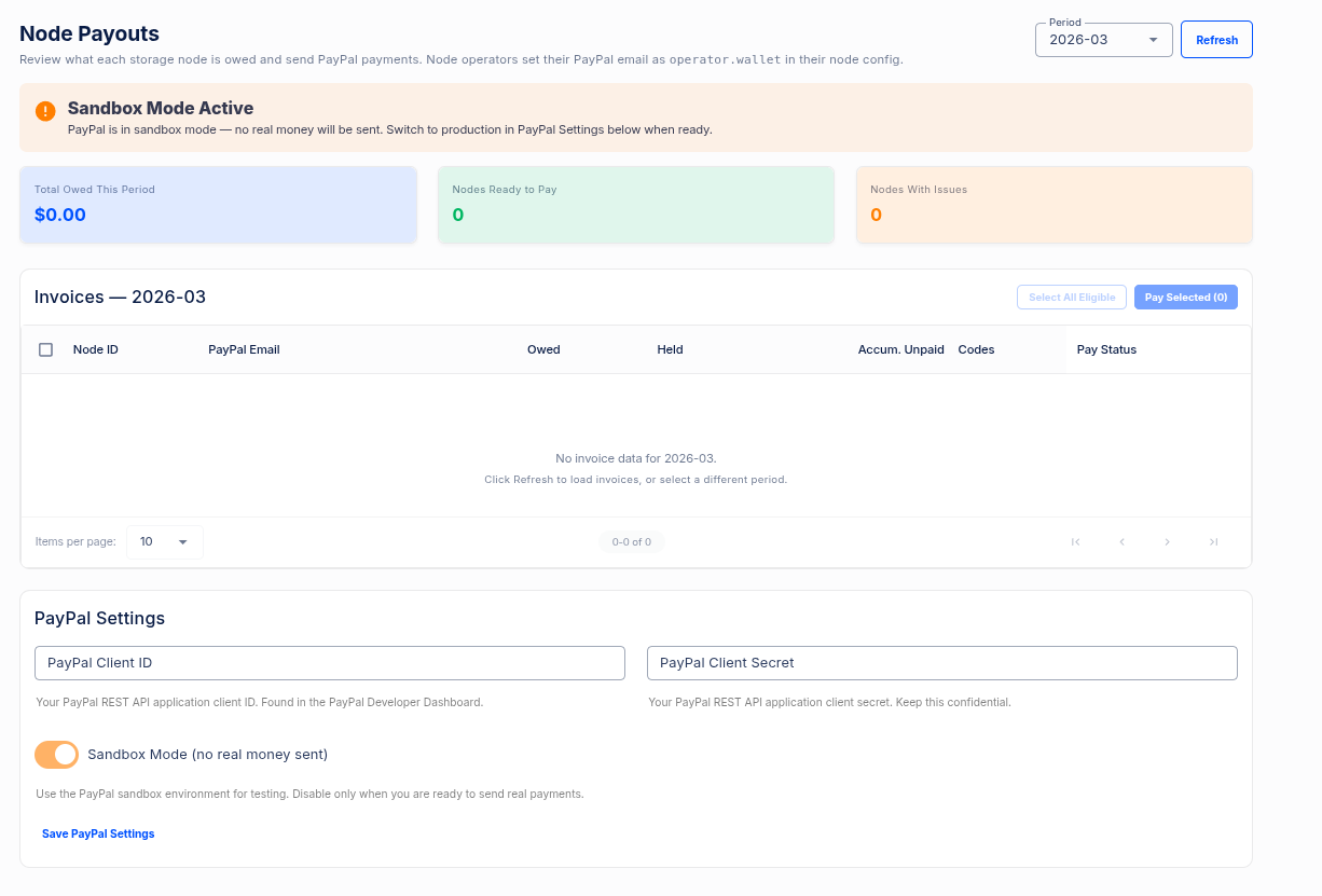

i also made a payout section for the storage nodes:
yes paypal not tokens (“funny money”), why? while crypto is great and all you never know what you get, exchange rates go up and down so much. if i where to bring this to market i think nodes should be paid in something stable that they can go and buy bread with
fee’s yes they are true in both crypto and fiat world, paypal take a cut even when you use their mass payout feature, paying out small bits is not good as the fee’s will eat up the payout, i did a ballpark estimate and for things to be reasonble i think a minimum payout of 20$ is about right

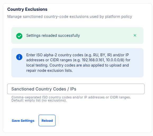

i have not tested it yet fully but the idea is that any customer or storage node within a sanctioned country are rejected automatic, customers are served a landing page that simply say we cant serve them since they are inside a sanctioned country, the same for the storage node

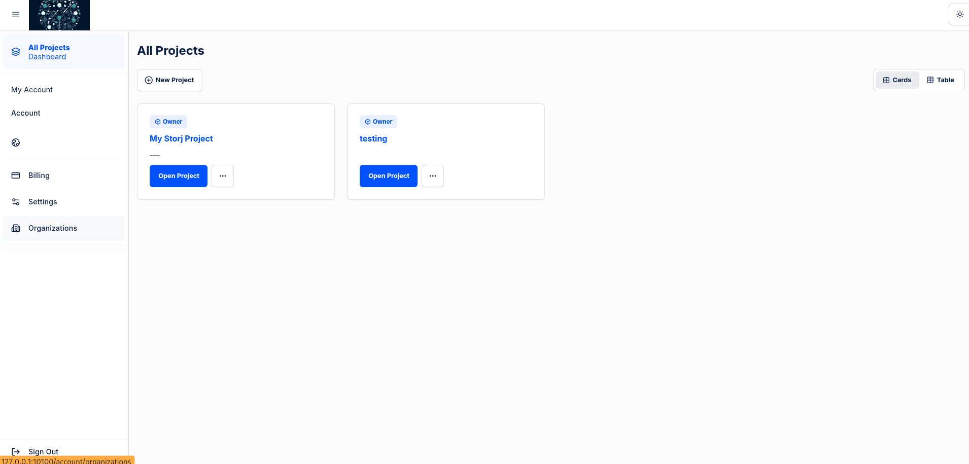

while at it looking at the customer side:
not much is changed, the dropdown in the upper right is moved to the left sidebar
but i have added a feature that allows a company admin to set up a org and invite users so they can access company projects, they should be able to do so without their own account present first, one will be created when they click the invite link
