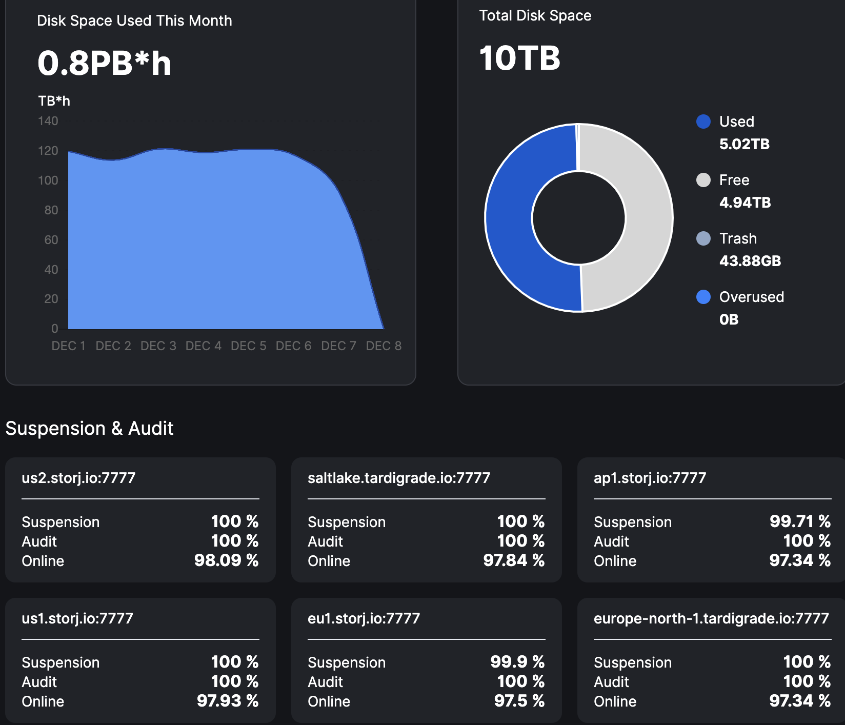

I’m running this storagenode over 3 years I think.
I received some email 30 min ago.
Your Node is Suspended
Node ID:
nodeidnodeidnodeid
Your Storage Node on the europe-north-1 Satellite was suspended because it produced errors too often during audits.
You were suspended on 2021-12-07 at 13:45 UTC.
Is it normal?
What can I do for stoagenode?

After some time, it became normal.
It seems that overseas’ IX line was unstable.
