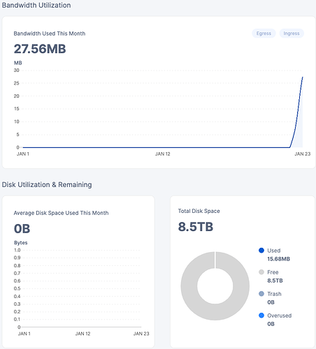

Lauched node without databases as you advised earlier.
as i can see Used space is wrong, it was more than 4TB used. Will it be fixed with future audits or?
