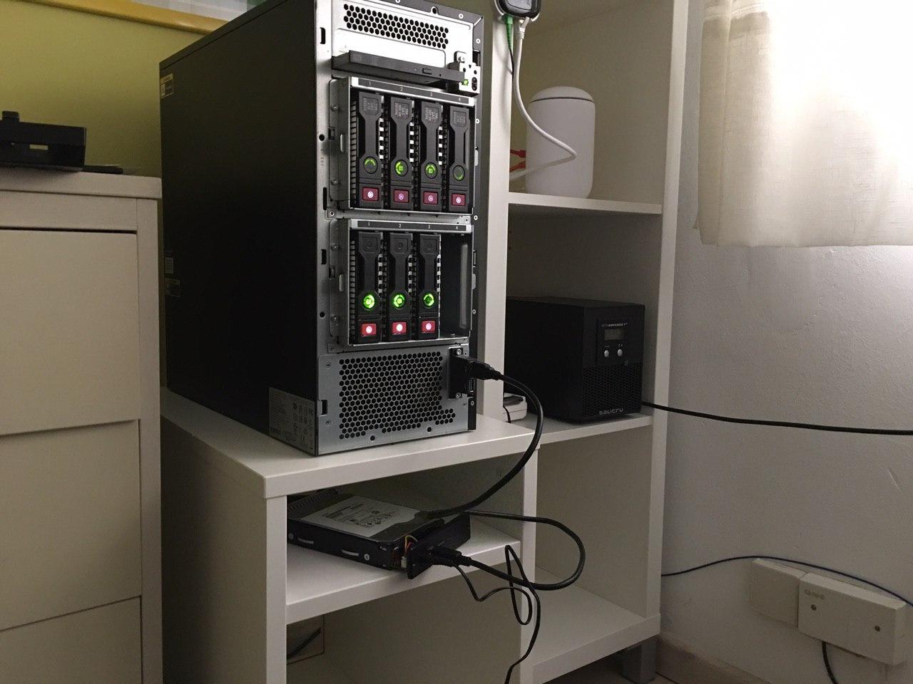

You are absolutely right, and I can still think until this Thursday that I have to physically go where the server is. It is clear that 8 × 10 TB in raid 5 is an aberration, but well, I’ll have to meditate a lot to see if in the end I change it to raid 6.
if memory serves it was still kinda tiny enough to be on one drive… so find a drive it will fit on with some headroom for maybe a week worth of ingress or limit the node size
then rsync or similar sync / copy program to a usb external or whatever… when complete redo the array and throw it all back… i had to do much the same for migrating my own node… was so much fun… took 5 days to copy the 9tb and then i spend 5 more to copy it again because i had made the blocksize to be 16k and it took forever to scan it… then on second try i made it to 512k blocks… tho 128k i what i should recommend, then it copied the at the time 10 tb node in like a day… world of a difference…

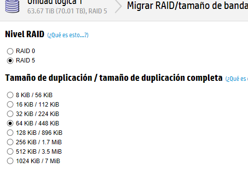

What you’re telling me is this picture thing, right? The size of the bandwidth, that the bigger the size, the smaller the total capacity of the disks, although I haven’t done tests.
The bandwidth size and that I can migrate it hot, since the controller allows it, but in case I finally decided to switch to raid 6, I don’t know if I would leave it in a big or small size. When the size is bigger, there is better performance, that’s what I understand, but I don’t really know if it will be very effective for the storj data. As for the audiovisual content I have downloaded to the server, I don’t care if it has a larger or smaller bandwidth size, what matters is for the 2.1 MB storj data.

The truth is that if the files are 2.1 MB, it doesn’t make sense to incorporate a 1024 k/7 MB band size. When the disk saves the file within a piece of band, a lot of space would be wasted.
Learnings from ZFS really can’t be transferred to RAID5/6. A strip size in RAID6 of 64k would lead to a stripe size of 6x64k = 384k in your setup. ZFS doesn’t work like that so it really doesn’t at all apply here. The impact on RAM is also negligible compared to ZFS. It’s a different beast, so when someone is asking about RAID6, lets stick to RAID6.
In general larger stripe sizes would be faster for larger files. Smaller stripe sizes are faster for smaller files. The default in most setups is 64k strip size and I would recommend sticking with that as it neatly lines up with the maximum file size for storj. 128k lines up as well, but would probably slow down the database writes and smaller pieces a bit more due to overhead. I don’t think that tradeoff is worth it. So stick with the default. Synology doesn’t even let you change it from that default as far as I know. (Unless you manually edit the config files)

I’m a little baffled that that is your response after it being pointed out several times that the OP is going to stick with NTFS, which on windows seems like the right choice to begin with. I know you’re just enthousiastic about your setup, but at some point it becomes counterproductive.
So on to the next step. There is no universal answer to this question. It depends on workloads and it heavily depends on size and type of the array. You link to a forum post of seemingly not very well informed people discussing a 2 disk RAID0 array. I don’t see how that is anywhere close to relevant for an 8 disk RAID6 array. RAID0 doesn’t have to deal with parity calculations on every write, which means it doesn’t have to go through the read write parity cycle like RAID5 and RAID6 need to. Therefor different optimizations apply. If a RAID0 needs to write something smaller than the chunk size, it just writes to a single disk and is done. RAID5/6 needs to always read from all disks, calculate new parity and write to all disks. So single disk write operations are out of the question anyway.
64k chunk size would already lead to a stripe size of 384k. With a 6+2 array, 128 stripe size isn’t even an option.
The options for chunk and stripe size would be.
4k/24k
8k/48k
16k/96k
32k/192k
64k/384k
128k/768k
etc.
Because of the file sizes of most storj data, 64k/384k would be a good match.
