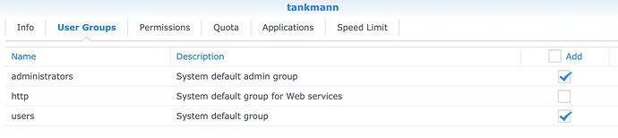

Sorry for the obvious question, but tankmann is an admin user and can log in over ssh right?
Yes, I can login with ssh and it’s admin.

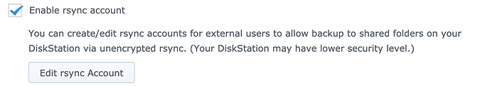

Haven’t used rsync on synology myself, but I have a feeling this page is going to be useful.
https://www.synology.com/en-global/knowledgebase/DSM/help/DSM/AdminCenter/file_rsync
Thanks - I had it enabled already but this might do the trick now, I didnt check the box and added an account (I though it takes the ones already created). Let’s see…

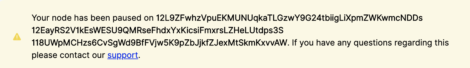

YAY. Just was able to move the Node to the Synology… it’s running fine as well, only problem now is, it has been paused :frowning: one or two days ago I assume from the logs on the pi3
Just opened a ticket for it as well. FYI
