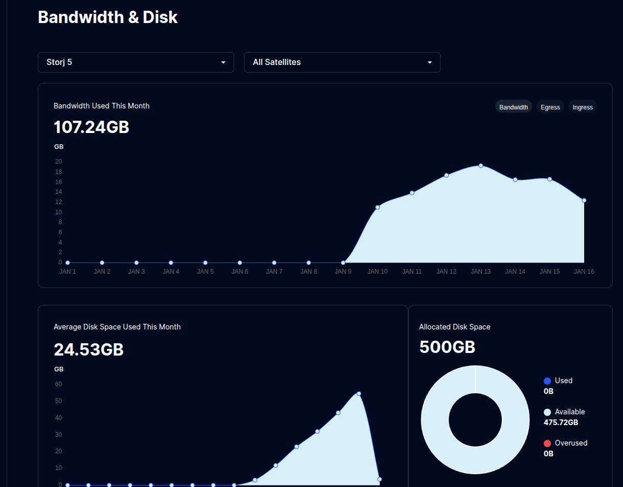

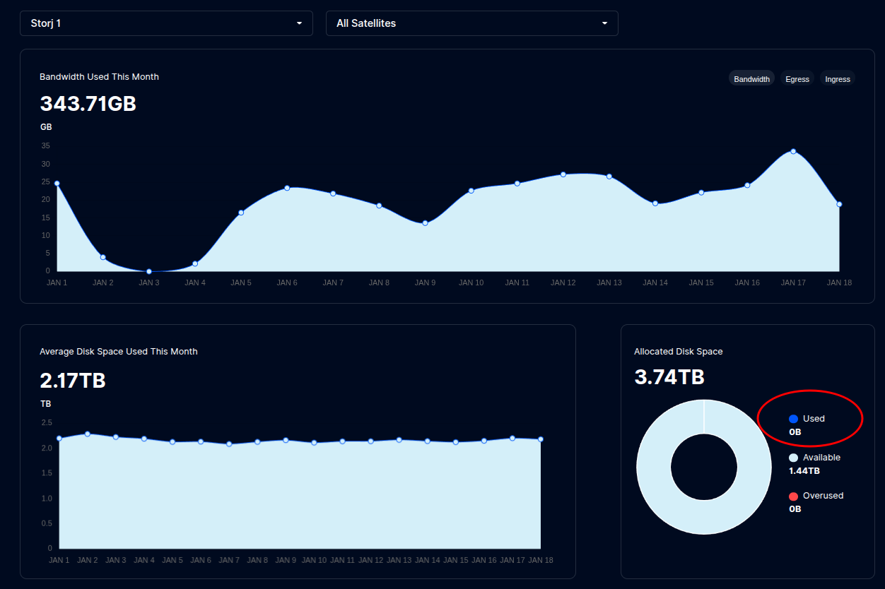

I’ve installed the Multinode Dashboard yesterday for the first time.
I’ve added several nodes but the used space is wrong for all of them and display “0”:
Example with one of the nodes:
Other data seems correct.

did you used dedicated disk feature?
I have the same problem, I think it’s due to the fact that the nodes are stuck at version 1.142 and the multinode is the latest
I wasn’t aware of this feature.

If you go to dedicated disk it will always show 0. That is why it was asked
Oh ok, thanks. So that’s not what I want lol

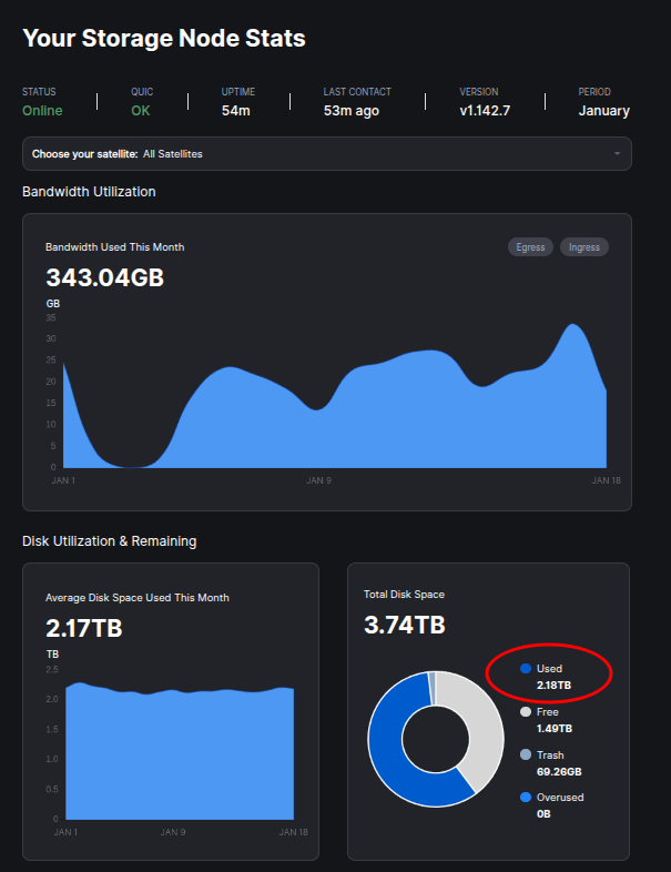

The dashbaord still doesn’t display used space:
But the individual dashboard is OK:
What is wrong with my setup?
