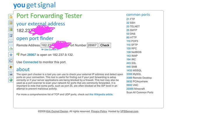

I have followed this checklist and my port is open.
Also I have checked nslookup for my DDNS and it is pointing to same ip in the log.

Your public IP and IP in DDNS are different. Please check your DDNS updater. It’s better to configure it directly on your router in the DDNS section. You may click there the Update button to check and assign a correct public IP.
Please also compare the IP from yougetsignal and WAN IP on your router, they must match, otherwise the port forwarding will not work (because your ISP placed you behind their NAT, it’s called CGNAT).
If they did so, you would need to contact them to rollback their change for your account and give you a public IP. It could be dynamic, but must be public (the WAN IP will match IP from yougetsignal).
