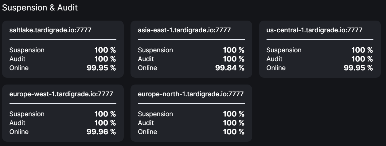

@SGC & @LinuxNet: You’ve got to be damn unlucky to be sent an audit during such a short offline window of 30~60 seconds…
That seems really unlikely! My nodes got offline during 1 hour because of my ISP lately, and only 2 sats (out of 5) noticed it:
i got nearly 15tb on one node… and get checked 12 days back i get just short of a thousand audits on a slow day and the peak was nearly 2k during a 24hour period… 60minute x 24 hours gives 1440 minutes in a day.
and so getting an audit every minute is just about the avg for me…
some of the sats didn’t notice i was missing for 30 seconds either 3 of them did tho, sorry 4 did
