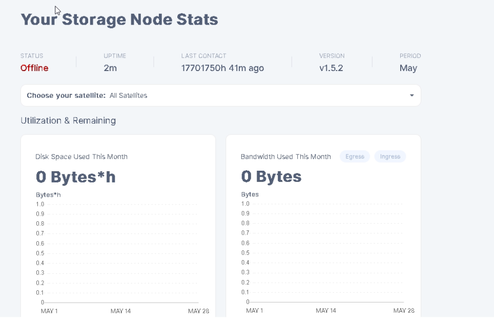

I have reinstalled the operating system from 0 doing all the procedures for a new node, but I get Offline all the time.
Ports opened correctly, static ip assigned to windows correctly, non-ip configured correctly. In my previous banned node I was online.
Storj process restarted.

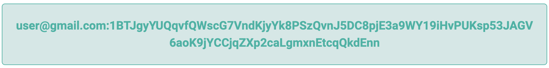

Error at ./identity.exe authorize storagenode … ((( Error: certificates peer error: authorization already claimed: )))

I have formatted my computer and started from 0, but when it comes to authenticating and putting mail @ … I get that error all the time.
I have tried both a clean windows and a clean ubuntu.
identity.exe authorize storagenode user@gmail.com:1BTJgyYUOq...
this is single-use authorization token
means that the token is already used
you must have a NEW token
Guys I have created one of 0 correctly, Thank you all very much.
