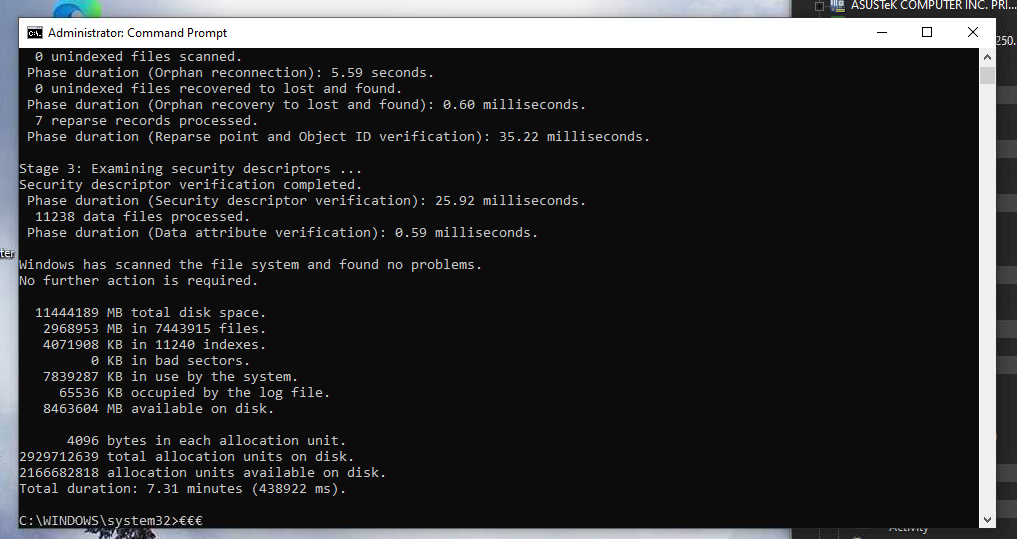

Try checking the disk
No problems on the disk. something else must be wrong then:

This error means that your filesystem is corrupted and needs repair. Please stop and remove the storagenode container, then run chkdsk /f e:\ from the elevated cmd/powershell, if everything is fine, but node still crash with this error, then you can recreate the info.db database:
So i ran the windows repair command - but it seems to have done nothing. so time to recreate info.db?
