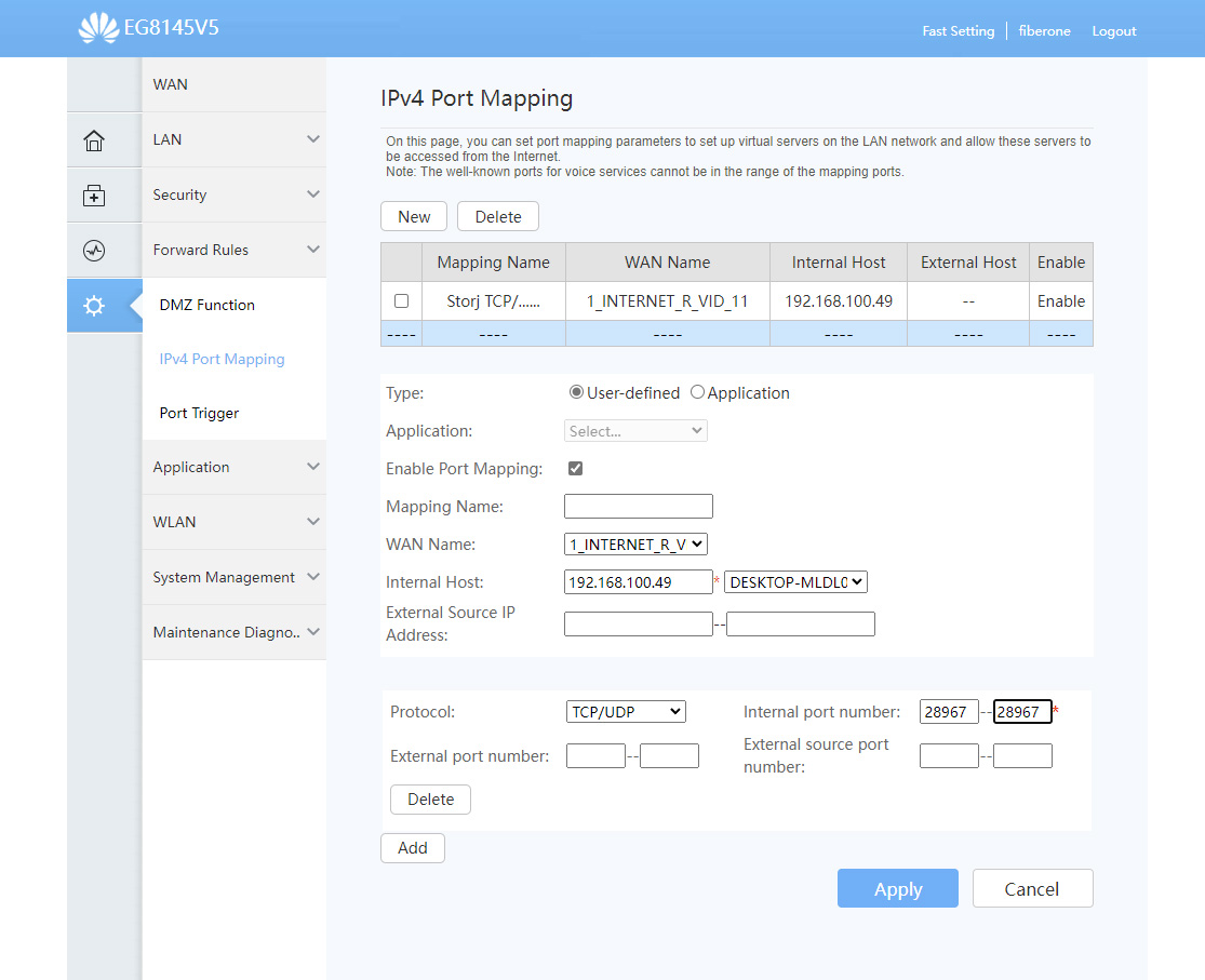

Hi, I’m setting up my first node and can’t open the 28967 port no matter what I do! I tried to configure my router but it’s not working! Win10 is properly configured to allow connections through Firewall.
My router is Huawei EG 8145 v5, Win10 21H1:

Do you have a public IP address listed in the router? The rule looks correct.
Please show Windows Firewall rules for 28967 to be unblocked, or the Windows firewall showing as disabled.
I tried disabling Win10 Firewall but it didn’t work either!
Port trigger should not be used.
The correct page is IPv4 Port Mapping to allow the port forwarding. Please include 28967 in the External port number boxes as well.

Disabled Port Trigger and changed the config of Port Mapping but didn’t work…

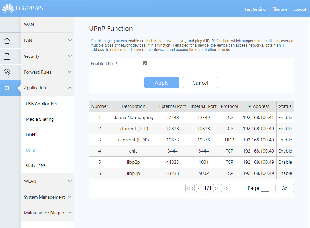

I’m suing BTFS and BTFS 2.0 running at the same time each at different ports 4001 and 5002 and they are automatically open using UPnP function of the router, why can’t Storj work like that?
Tried disabling Windows Firewall and UPnP on router, nothing changed. I will try tomorrow on a fresh installed Win10 as a last resort!

Hi @ZeroCool1974-BR .
That is terrible information :frowning: . I want to help you. Please, look on my screenshot. I have newer version of same router, like you have and this is working setup for me.
I think, that “External port number” must be set too.

  • double check router setup (see my screenshot)
