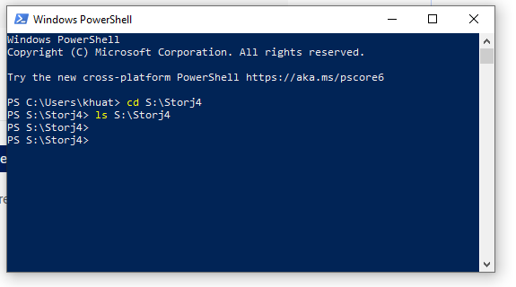

Do you have anything in this folder?
Please, copy result of the command (PowerShell):
ls S:\Storj4
That folder is empty.
I checked with the latest installer. It will create all needed files only on setup.
If the folder for data (in your case it is a root of the disk) is empty after the setup (was cleaned or have an error during setup, etc.), the attempt to start a service will fail.
It was implemented to do not start with empty storage in case of disk disappearing or other disaster and do not disqualify your node.
So, in this situation, when access rights now are fixed, you should reinstall the storagenode.
