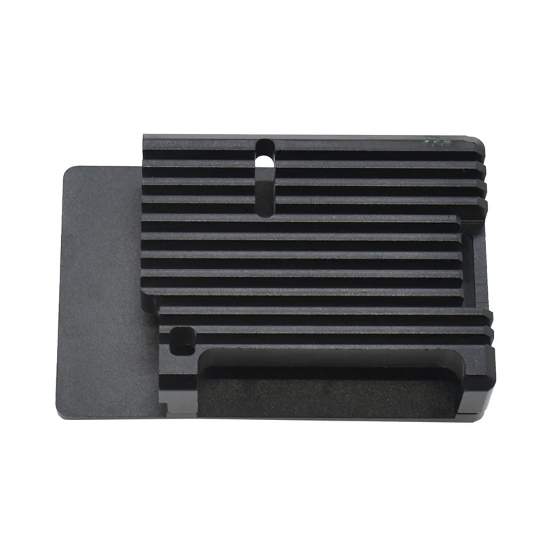

I found these passive heatsinks/cases. They are the best for RPi. No soldering, no noisy fans, while the CPU temp drops down about ±15’C degrees. If used proper thermal paste it can go up to 20’C degree down.
