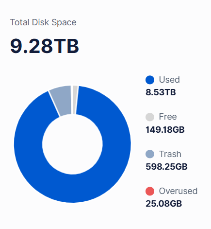

115
My three nodes have less for some reason
Mark
February 25, 2025, 4:00am
116
How old is the node in the picture?
Vadim
February 25, 2025, 9:45am
118
I also see around 10% in trash from 108 nodes, so it looks like long waited cleanup.
Ottetal
February 25, 2025, 11:03am
119
How do you both have free space and overused?
snorkel
February 25, 2025, 11:20am
120
I believe it’s a multinode dashboard.
Yes it’s the Multi node dashboard. I have free space and overused too.
Also is see in my nodes about 10% Trash
Ottetal
February 25, 2025, 11:55am
122
@snorkel , @MarviBiene thanks lads, that makes sense
