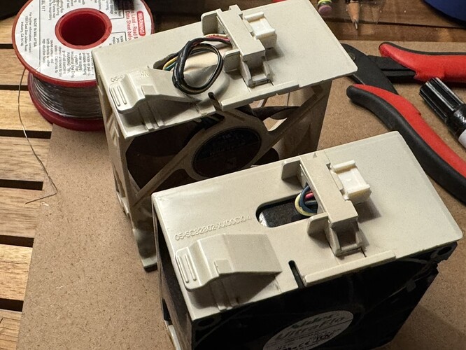

Can’t comment on performance (Noctua did make my old HP Microserver quite a bit less noisy), but next time consider using Noctua Extension Cable NA EC1, changing the pinout is trivial there without destroying cables.
Pinout is the same. I cut them for two reasons:
  • make it shorter
  • Supermicro connector has detents that keep the plug attached to the case:
